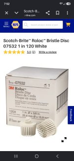

Found these scotch brite wheels on Amazon. They work out to about $0.11 each. Went through quite a few but I think it was worth it. Rivets look good with mandrels filled.
