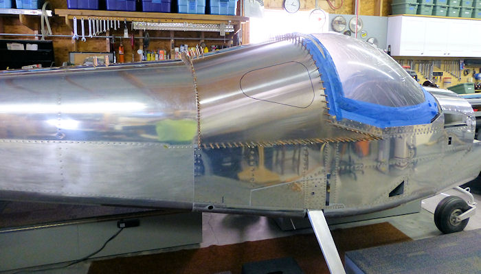

This is what I am working on.
http://www.joesrv12.com/Builder Log/al_07_01.htm
If anyone has experience bending Plexiglas please let me know.
Can I heat the small side windows and bend them around the aluminum or do I need to make a mold for bending
any help will be appreciated
Joe
Joe,
If you heat those small pieces to a pliable state, your heat source needs to be pretty close to the aircraft. The acrylic will start to cool very fast, and you won't have too long to work with it. IF you went this route, you'd need a helper to quickly hand you the 'D' windows while you are inside the fuselage, then you kind of hand form them into position while waiting for them to cool. But even then, you may not have enough time to work the material. I'd build a simple form and drape form them outside the aircraft, let them cool, then proceed.
It should be very easy to measure/map the radius of that area, and build the form. You can obviously map the radius' from the outside and build the form. Cover the form in felt, heat your material, and drape it onto the form while it is still very pliable. Hold flush on all edges until the material cools.
Gary
I think that is the best way
If I roll the Fuse on its side can I use Plaster of Paris to make the mold from the inside or is there a better material.

How about this idea? To make a female form, put some wax paper on the fuselage to protect it, then layup some some wet fiberglass on the wax paper. Some wooden battens can be laid on the wet fiberglass to reinforce it. Cover the battens with another layer of fiberglass. Keep in mind that I have never done this.
Joe
I think that would be the best way and I will save the molds to use in the future.
Joe D
Or how about covering the outside surface of the aircraft with felt. Then heat the acrylic and lay it onto the felt and hold it until it cools.

This was my first thought but I am not sure that the Plexiglas will stay hot long enough to get from the kitchen oven to the shop, however I think I will try this first.
BINGO! This is exactly how I would make my forms!
Joe
It typically won't, Joe. Unless you run like a cheetah. This polymer will still feel hot for awhile, but it's got to be right at a perfect temperature to be pliable enough to form to a tight fit. I'd go the fiberglass mold method. Heck, you've got an electric opening canopy, and all sorts of other innovative designs....you ought to be able to whip out a set of molds in seconds! :D

Small parts like this can be placed in the oven. Just be sure the wife is gone while you do it :p
On larger parts, we use heat strips, which are basically round rods that are electrified and heat up lengthwise. These are for area specific bends and curves....they are fairly directional. To form a larger piece as a whole, it takes what is similar to a giant oven and the machine evenly heats the entire piece at one time. But despite how hot it 'feels', you've still got to work rather quickly.
