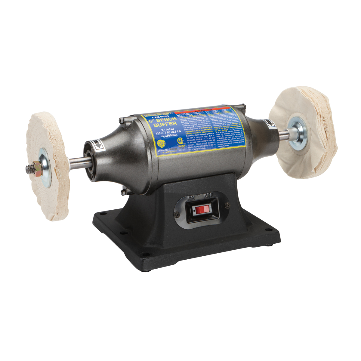

Anyone have a place to by 6? scotch brite wheel for bench grinder? The one I purchased from McMaster did not last long.
A grinder is too fast for making the scotchbrite last IMHO. I chuck mine in a variable speed standing drill press and so far one has lasted me thru my entire build - year 5.5 now......I dont know what speed its on, but its probably no more than 500-700rpm - not super fast and for sure not even remotely as fast as my grinder......

The rate they wear depends on the one used, and how it is used, and not so much how fast it is turned. The best tool to mount one on is a powered buffer. It has no shield to limit access to the wheel and the shaft is long to move it farther away from the motor and give good access to the wheel.
The cheap one at H.F. hold up just fine for this use.
The wheel we use in our shop is the same one sold in the Van's Accessory catalog. We use it a lot, but it lasts a looooong time (probably a couple years at least).

On Scott's recommendation, I went and bought the HF buffer as shown above. It has held up extremely well and the results using Van's or a 3M wheel are excellent. I now have a deburring wheel on each end of the buffer. One has a round profile on it and the other is flat. I imagine that I could produce two RVs without replacing wheels using this system.
