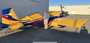

Here's a couple photos from AIrventure 2023 of what you can build from our parts....
Darryl and Milanka Hudec's Grand Champion Gold Lindy kit built, Oshkosh 2023
Bob Baker's Bronze Lindy kit built - Oshkosh 2023
Milanka "Minya" Hudecc, Darryl Hudec, Bob Baker, and Vince Frazier at the Airventure awards ceremony, 2023.

Another teaser here.
Travis Lattin started this project, using our parts of course, just over 2 years ago. He expects to be flying in March.
