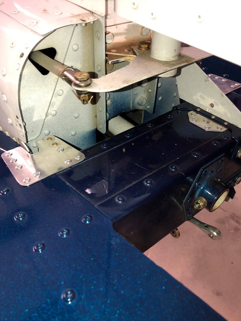

Thank you for the sound advice. I am very fortunate to have an experienced mechanic ready in the next couple of days to open things up and install the sb fix.
Exercoupeguy...in order to do the SB inspection the Stabilator needs to be removed and parts disassembled in order to inspect for cracks...according to the SB.

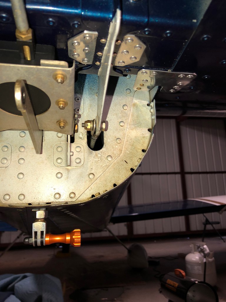

My A & P and I removed my stabilator, inspected the spar and found no cracks. We will proceed with installing the band-aids when the parts arrive, hopefully today so I can get back in the air. My RV12 has 250 hours, is hangared and I place a gust lock on when parked outside.

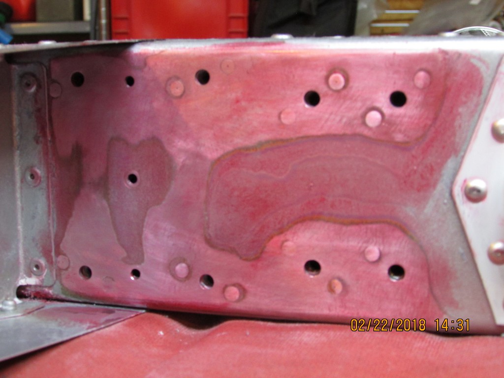

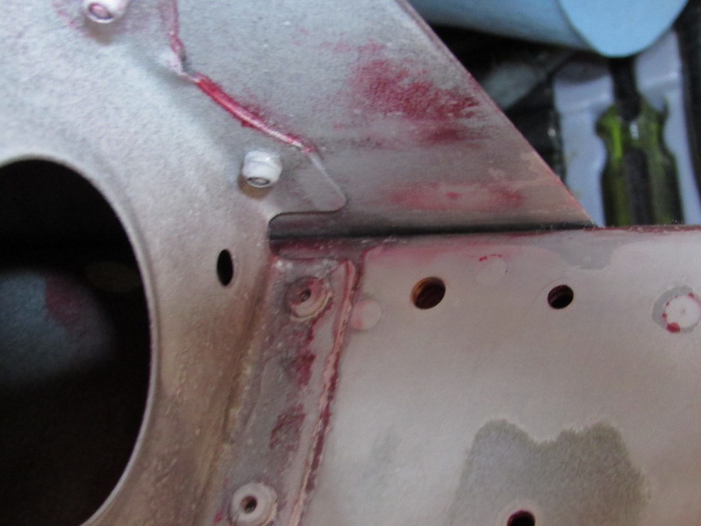

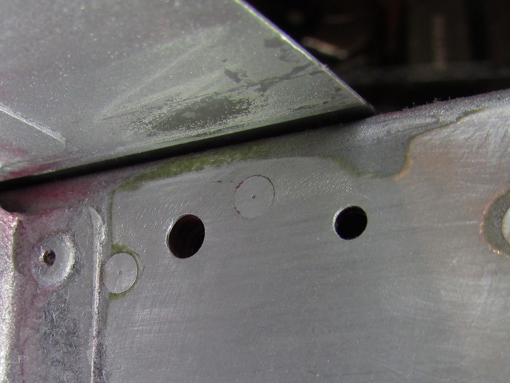

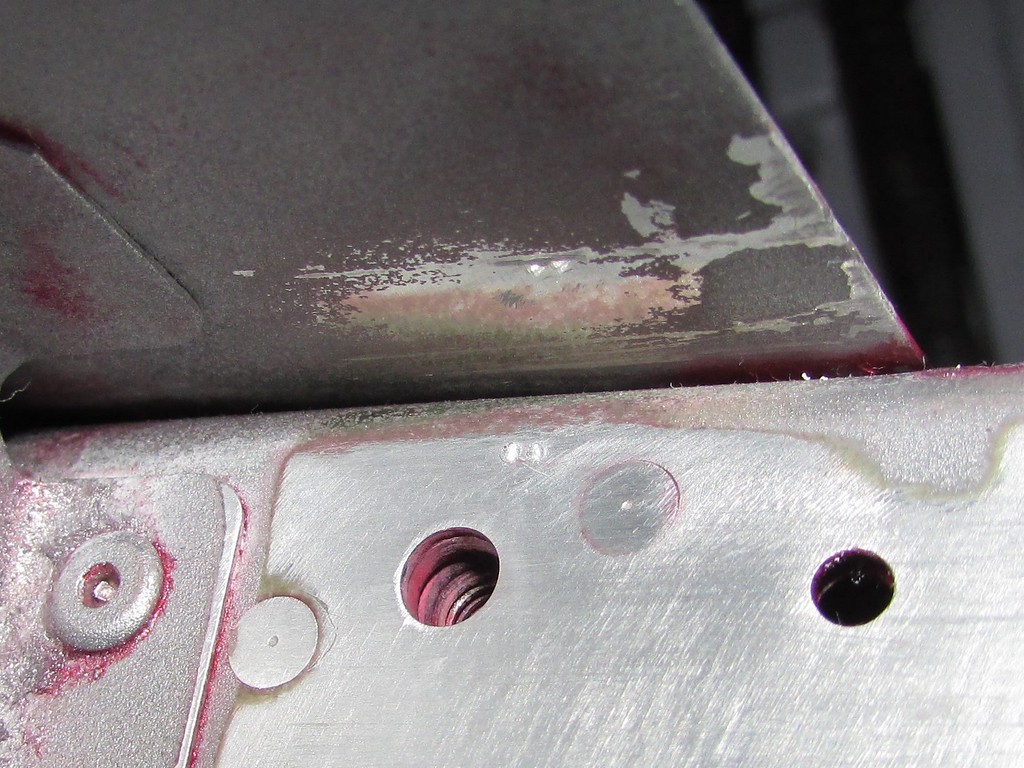

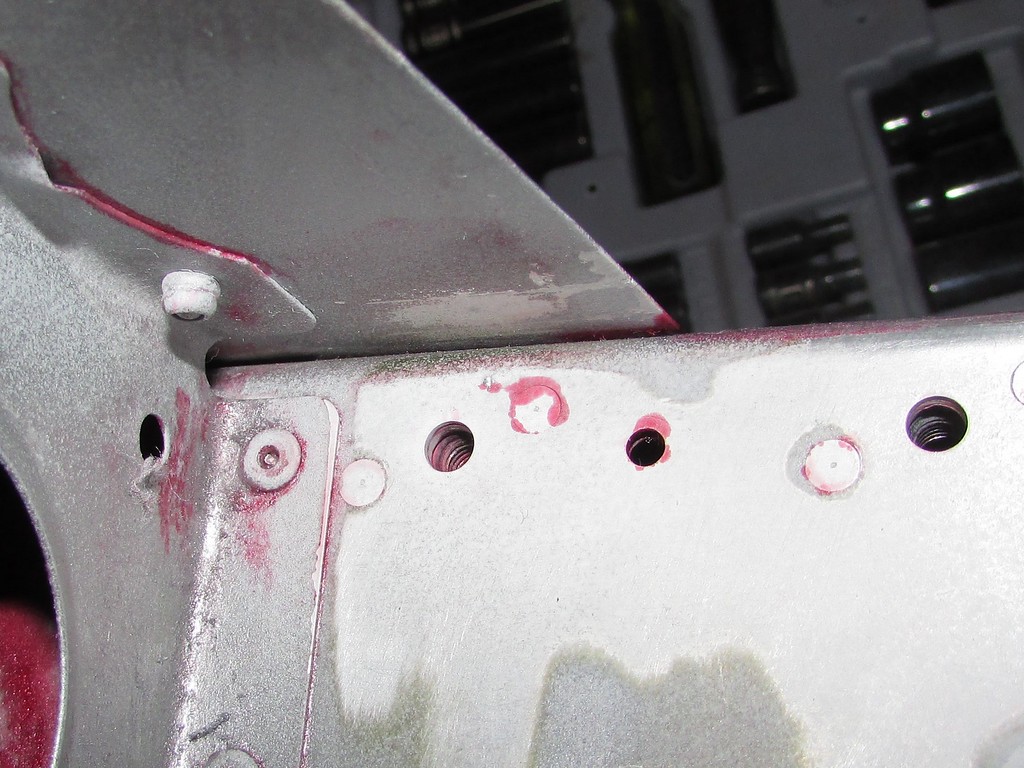

Found a crack
120323 290 hours on the Hobbs. I had not applied dye penetrant before but had watched the application on larger part.
Facing forward, it was at the right outboard hinge bracket, upper bolt nutplate, inboard rivet. It was about 1/8 inch and went into or came out from under the rivet. The good news is I need only one stop drill whereas it appears to me the SB example would need two.
I needed the dye to see it. In fact, I missed it the first time with the dye but was not satisfied with the developer cover, too thick I thought. Since it was a tight area, the spray dye was too much and is probably still wicking down the spar toward the tip. I did spray it lightly.
The next 3 or 4 times I wiped the dye on with a rag. Wiping on seemed effective as long as I kept the surface wet. Cleanup was much easier.
Once I knew where the crack was, I could see it with a 10x loop or use the macro setting on the camera. I could not have found it without the dye.
I tried it four times instead of three because when I wiped the third test, I could see the crack but could not see the end. On the fourth test, I center punched the spot with the dye and developer still showing the end, I hope.
The servo tabs did not present a dye indication.

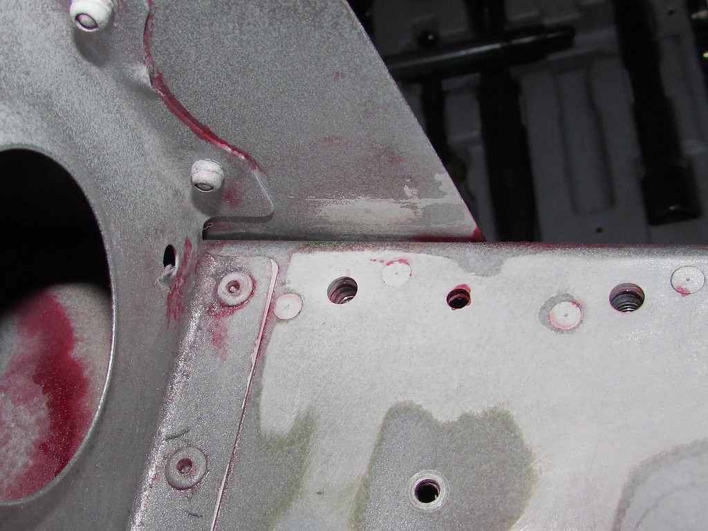

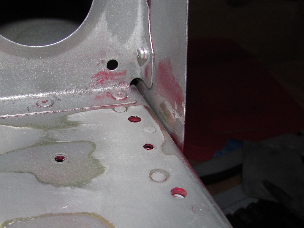

some photos of crack in 120323

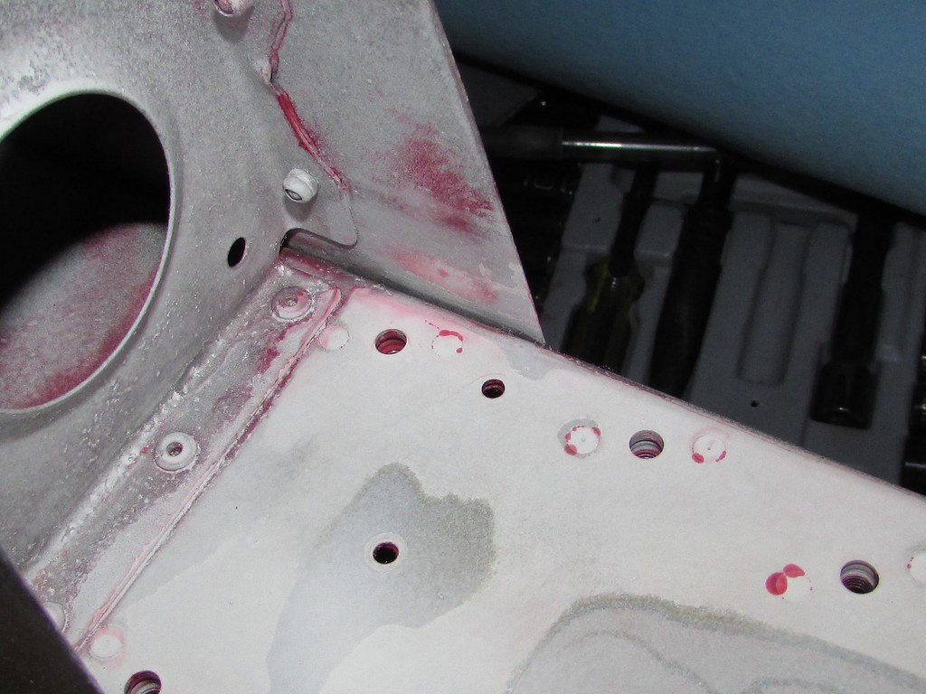

When I saw SB18-02-02, I was thinking about blowing it off. Can't be me. I am too careful with the airplane. That thought was short lived as I know that Van's engineers are careful and thoughtful with subjects like this.
I ordered the dye penetrant kit and started in. It was a learning curve but not difficult at all. I did find a small (very small crack) and I played with the testing to see if the result was repeatable. I thought that it may be helpful for those trying dye penetrant for the first time to see some of the steps that I took.
It was hard for me to control the dye and developer spray into the tight corners. The first try was a mess with dye migrating into the stab skins (probably still migrating). And I did miss the crack.
Next, I used a rag to apply the dye. I kept wiping at several minute intervals for the next 15 minutes. The dye appears oily and did migrate into the crack and around the rivets.
1
The next photo is out of sequence, but shows the crack, highlighted with the dye. Later photos show why the dye is a must.
2a
In one series of tests, the dye is very visible at the rivet, but barely showing at the crack.
3a
Eight minutes later, the crack is visible.
4a
With the area wiped with the solvent, the crack is barely visible at this angle. It could be still damp with the solvent.
5a
Another test shows the crack. This test used a lighter application of developer. You can see the dye from the first test migrating along the spar.
6a
Five minutes later, the dye is spreading. Watching how the presentation progresses is helpful, at least it was to me. I did this last test so I could see the end of the crack. Wiped clean, you can see the crack but not the end. Noticed that I missed with the punch.
7a
The second punch hit the end of the crack, then I wiped the area clean. The crack has again disappeared
8a
For those of you that have this chore coming up, hope this helps. I would not have seen the crack without the dye penetrant test. I did flood the area with solvent, tried the developer without additional dye, and had a very weak signature. Wiping the dye as described above again produced very clear signatures at the rivet heads and crack, without the mess.

Your crack is consistent with my view.
Note: the nut plate rivets are at about a 20? angle to the top of the spar.
The photo in the service bullion the rivets are parallel to the spar.
It look like Vans made a change in this at some point.
Maybe to move the rivet away from the base of the bend in the spar flange.
The HS-1209 spacer at the back of the hinge is not doing the job in my view.
If the rib was shorter in the X access and the spacer was in between the rib and the spar the loads would be better dispersed. ( X to the left Y to the sky ) My View
The pulling back on the stick to fast or hard is putting a lot of stress on the top hinge bolts.
inertia of the stabilator and counter weight is not helping.
My View
I would like to see any photos of any cracks at the bottom of the spar.

Thanks for the pictures and explanation John.
In several pictures I see what looks like a crack by the left rivet of the nut plate. However, it doesn't seem to absorb dye.
Jim
Jim, thanks for the observation. I looked at it with a 10x loop and more camera shots, playing with the lighting. It looks like a crater but green primer is at the bottom. That means it was there before the airplane flew.
I did the dye penetrant test again. I "flooded" the area with dye using a Q-tip. No signatures at 12 minutes, but plenty of signatures around the rivet.
I will try to sand to get to the bottom of the green and test again. Whatever it is occurred at construction. It could be growing at the lower portion, but no indication.
Update: Buffed out with 400 grit paper. No marks, retested, no indication.

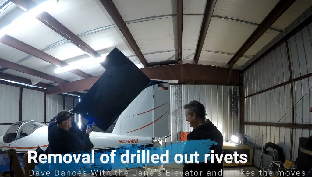

Jane is having major surgery SB 18-02-02 the elevator.
Jane is very fortunate in that she is rich with friends that want to help her out.:) This time it was major surgery SB 18-02-02 the elevator.
Dave, friend and A&P mechanic, came over with his specially built table just for the RV-12 fleet.
His table is already reserved for use for another RV-12 at Wings Field.
Certainly made the job a bit easier, just slide it under adjust height to match and we were all set.
Service Bulletin 18-02-02 to address any potential cracking in the horizontal stabilator front spar.
Did not find any cracking on Jane:cool:, however, performed the SB as a prevention measure.
Had to hold for 24 hrs due to finding one of the bearings would slip out of the flange with little pressure.
Put Loctite on it and checked the following day and we were good to go for Elevator installation.
Click on image to see Time Lapse video of the surgery.
Hey Skunkworks, Thanks for the visual. Did you loosen cables in the process couldn?t tell. Or, just detach at the HS horns? Does that table adjust for absolute fit or just stuff a magazine or something to align? Thanks again!!
I?ve done two so far and did not loosen the cables. Using the table, you might have to nudge the hs a little up or down when installing but works well and keeps the fuselage from getting scratched. I did my own using the table with no help whatsoever. You could use other stands, props,etc. having a stand that rolls is a big help.

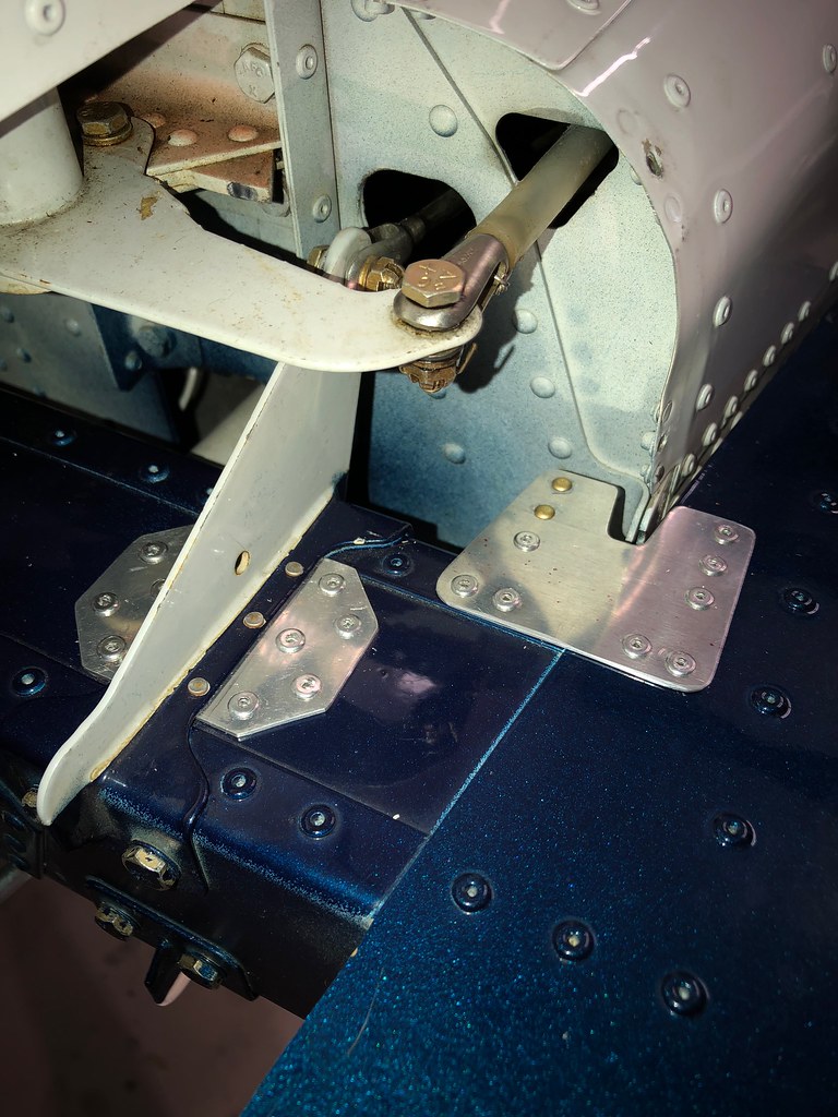

I haven?t got to thes skin doublets yet. Would it be easier to put the stabilator back on and then install the skin doublets?
Hmmm --
Don't think you could. Solid squeezed rivets would be hard to do. Flange to rivet to would still be there. I better say no you can't. Having smaller hands will help. Just not a fun job.
just finished today. Not mentioned in the instructions is the potential for interference between the top tailbone fairing and the gusset at full displacement of the stabilator. Mine did interfere and I had to file an eighth of an inch of the fairing above the gusset.
