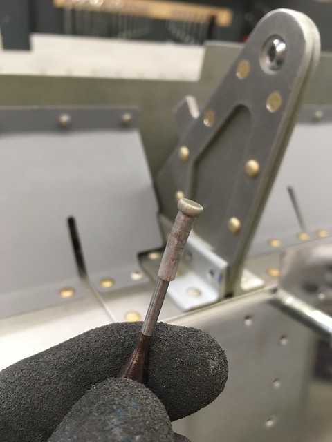

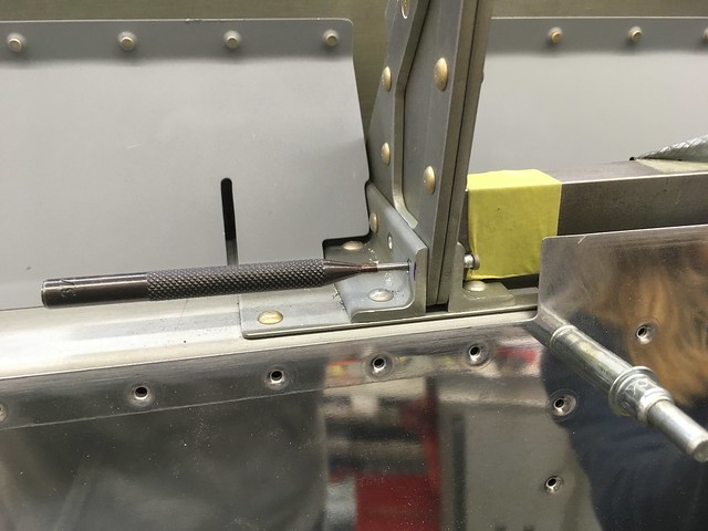

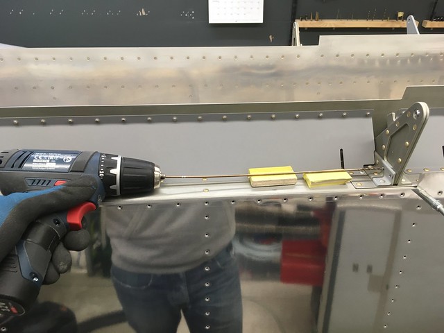

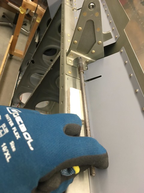

Considering that there is about 1/2" rivet shaft inside the hole, I tried all methods I knew how to get the shaft out, including using a modified C-clamp with a dimple die set, using a dimple die set with the rivet gun and backed by a heavy bucking bar and nut on the other side. No matter how high I raised the air pressure on the gun, the shaft would not budge any. The only choice was to drill it out.

I will review section 5 again and if you know of a method to accomplish this task other than what I have already tried, please let me and other know here. It would be a very valuable information to have.
Drilling the head off of a rivet and then trying to drive it out with a punch or other tool (regardless of the force applied, I.E., rivet gun, etc.) is problematic because the force you are applying is actually trying to further swell the rivet. Just like when it was originally installed. The situation is even worse when it is a long rivet through thick material because it just increases the friction that resists the rivet from sliding out.
If you instead drill off the head as usual, and then drill an undersized hole down the center of the rivet (#40 in the case of an 1/8" rivet) and stop about 1/16" shy of drilling the full dept of the hole, you have a hole that you can drive at the bottom of with a pin punch of appropriate size.
With this process you are stretching the length of the rivet instead of compressing it. The stretching process actually reduces the diameter of the rivet enabling it to more easily slide out of the hole.
Scott describes the only reliable way to drill out any rivet where there is some length to the rivet. The only requirement is that you drill down through the centre of the rivet. This can prove problematic if the rivet is in an awkward location. Take your time getting things square. If you have problem with that, make a little drilling jig. A chunk of aluminum or hardwood with a end that is exactly 90 degrees. Drill a hole through this small jig and use it as a guide to keep the drill going straight through the part. A piece of a hardwood broom handle for example. The options are endless but the point is that you have to drill through the centre of the rivet to the depth described by Scott. After a few thousand rivets you will no longer need drilling jigs as your eye and hand will "see" and feel, the correct 90 degrees.
