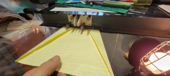

1) Remove the 6 top and 6 bottom skin/flange rivets. Maybe remove one more on the lower side if needed to make the lower slot bigger.
2) Make a folded paper "dust pan" and slide it through the newly created lower slot between the skin and spar flange to catch the rivet tails and swarf. Drill and pop out the rivets that hold the hinge brackets to the spar web. Remove the dustpan and swarf.

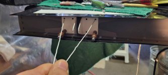

3) Put a couple 18" scrap wires through two top rivet holes in the spar web and tie knots so they don't pull out.
4) Fish the wires out through the lower access slot between the skin and spar flange.

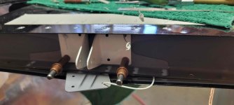

5) Put the wires through the corresponding holes in the doubler. Tie knots in the approx middle of the wires (not at the end).

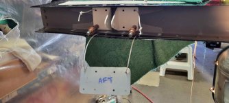

6) Mark the doubler orientation fore/aft etc.
7) Push the doubler with wires attached through the slot and pull it up onto the front side of the spar with the knotted wires. Cleko in place, cut and pull out the wires.
8) Before match drilling, once again slide the paper "dust pan" through the same slot to catch the swarf, and to catch the doubler for easy removal, paint and deburring.
9) Repeat steps 3,4,5,7 for final assembly and Pull Rivets. Easy Peezy.
