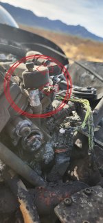

He posted on another social media platform yesterday, made a fine landing and walked away. Has not examined the FWF yet but speculates it was an exhaust leak.
Bummer. That's scary. I wonder what caused the fire.
I hope Teal is ok
Very glad he's ok. This is his account of what happened:
"I just wanted to be the first to tell you guys I had an in flight emergency today. The cockpit filled with smoke and it appeared the cowl was on fire. The engine was still running so I flew for a couple miles to get close to a road then secured the fuel and shut it off. Uneventful landing on a paved road with no cars around. There were flames coming out of the cowl vents so I covered every cowl opening and was able to put it out but not before it burnt the front up pretty good. More detailed investigating will unveil more but initial thoughts are possible exhaust leak either at turbo or crossover pipe. Shroud your exhaust really good!!"
HIS UPDATE :
"I believe that we found the cause of my inflight fire. One of the fuel rail fasteners had backed out and allowed one side of the fuel rail to lift of the #1 fuel injector causing a fuel leak or possibly a spray. I am very disgusted and disappointed in myself that I did not either safety wire or thread lock those two fasteners but at this point the best I can do is warn others. This was one of the Skytrax designed fuel rails made of aluminum instead of the stock plastic. I am certain that it was not the fuel rails fault but the stock rail uses a flange head bolt with a soft polymer washer and I used a socket head cap screw with no washer. This may or may not have contributed to the fastener to loosening. At this point I would suggest either thread locker or safety wire on these fasteners. See the attached picture for the gap between the fuel rail and mounting spacer as well as the fastener head gap. For those that asked...the fire was put out by placing anything I could find in every cowl opening to starve it of air. This included my jacket, a towel and some rags I had in the back and every item I could get off bystanders."

Ouch. That looks like pretty much a write-off of everything FWF, and maybe the firewall too.
I am relieved yet very disgusted with myself that I did not safety wire the bolts that held the fuel injector rail to the injectors. I also got used to flying it and not opening the cowl every 10 or so hours. I could have caught this bolt coming loose on a quick inspection. I was approaching 300hours on this engine in flight and absolutely loved everything about it. Very Sad that another conversation engine goes down for such a silly mistake.... I will have another one of these engines flying in something at some point.
Shows the inherent risk when experimenting with something outside the normal engines.
It's good to know that your on the ground in one piece and able to rebuild and fly again another day.

Teal- If I might comment. It's easy to kick yourself when something like this happens, and yeah, it sucks. But it seems to me that you learned something very valuable from the incident, and a lot of other equally valuable stuff prior to that.
I've spent my career in aerospace, starting as a flight line mechanic in the experimental prototype hangar of one of the major Wichita manufacturers. In that environment, preflight and post flight inspections are about as stringent as humanly possible with calculations detailed engineering oversight and contingency planning in abundance for literally every flight, yet even with all that, I've seen lots of stuff broken in seemingly ridiculous ways.
You can't plan for every eventuality, but each and every event like this can teach something, whether it leads to a process change, a system redesign, or some other product improvement that gets us where we are.
You learned a bunch of stuff that will be foundational elements for next time, provided an honest evaluation of what went wrong as a cautionary tale to others who may come after, and most importantly, nobody got hurt.

To be fair, if the failure was caused by a lack of a safetied fastener, that failure could happen on any engine, Lycoming or automotive. What's unfortunate is that the naysayers will use this as one more data point justifying their put-downs of converted engines without looking further.
This, 100%. It looks like it's rebuildable from the photos we've seen.
