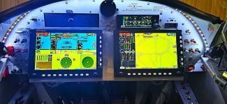

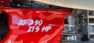

My friend, Scott McElroy, received Reserve Grand Champion - Homebuilt at the 2026 SnF.
He doesn't do much posting (or talking about his excellent work), but has given me permission to share a few things here.
I will include a picture or two here, and he and I will get some additional photos to post a little later.
This plane honors the Tuskegee Airmen, and I will admit my bias, as I not only was around during some of its construction but was also given the honor of flying it to Airventure a year or two ago, where the workmanship was recognized.
Since then, there have been some "upgrades" that will be highlighted in a subsequent post.
Some summary info:
Lycoming IO-390 EXP 119 (215 HP)
Whirlwind (HRT) Constant Speed Prop
Dual GRT 10.1 EFIS w/ Garmin GNC 355 (GPS/Comm)
CUSTOM Air Intake flow tested at AirFlow Performance
CUSTOM 4 into 1 Exhaust
CUSTOM Panel Mods (Many, including 3D printed "Glove Box" Panel Insert)
There is a backstory to this, which I will share later. Just wanted to post this and a few pictures now, with more later.

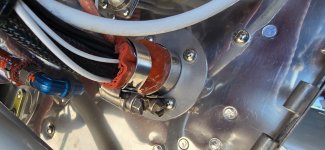

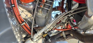

His best work, in my opinion, was under the cowl. Fitting that 390, with the custom intake (we did a 3D scan of it for Don at Airflow Performance), and the custom exhaust took a lot of work, but in the end seemed to be really worth it. It is the best work, in my view, because you don't realize how hard it was; it just looks right.
A thanks goes out to the judges at SnF for appreciating the work of a TRUE homebuilder, who did every bit of the work himself, except for the paint on the prop and seat covers, (with a minor hand from buddies here and there),

Doubt this will help you much at all. As I recall from seeing the installation, Scott’s inlet is a modified version of a Van’s snorkel. Nothing at all like the SJ inlet on the lower cowling.
I second the more pictures needed. Looks beautiful from what you have posted so far. Will it be at Oshkosh this year?
Regarding OSH, I am not sure.
We will be talking about it later this week or next.
You are correct, Krea.
The modification fixed TWO issues.
1. Make it fit.
2. Make it FLOW better (and thus more HP from the engine possible)
The reason it is known to "flow better" is that we took it to AFP and tested it. Don @ AFP validated it. ("I saw the test with my own two eyes!" :) :))

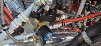

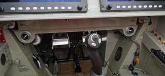

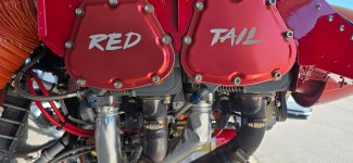

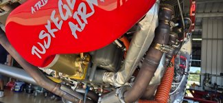

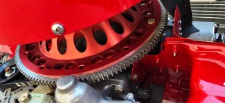

I finally got a chance to get some photos with the cowl off to add to a few from inside. [Scott had hurt himself and was away for a couple of weeks, as was I for different reasons.]
I think the 3D-printed "map box" is "pretty not bad!", but I like the cabin air distribution system beneath the panel the most. I plan to copy it for my 8.
A lot of the stuff from under the cowl won't be as meaningful if you are not building an 8, but it will be more meaningful if you are building one with a 390.
As mentioned, that intake was cut and reshaped for a better fit and better airflow (++ HP!!)
I think that the judges appreciated his paint work. I will add some up-close photos of that later.
Now, to be honest, I almost hesitate to post these photos for fear of someone looking to nit-pick a friend's plane, even though he gave me permission to do so. If you have questions about anything, though, I am sure that he will spend a near-unlimited amount of time going over what he did and why. Finally, I think to appreciate this plane, which has now over two (or is it three??) year flying, you have to see things up close and in their totality since the finer details are subtle and can be missed.

I'm really interested in the heat-shield cloth wraps on the intakes - what are those?
Might be something like this:
I have them on my RV-10, easily worth 15hp 😜
