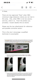

I’m the proud owner of a new to me RV6A. Going through it pretty thoroughly and the pre buy identified missdrilled/ poorly aligned attachment for the empennage. Reference drawing 34. I understand Vans has a kit or drawing or something that describes a repair? I’m probably not describing what I mean well so see the pictures for details.
Any help or reference would be appreciated!

There is no kit available.
If you contact tech. support they should be able to provide you with a diagram showing the recommended re-enforcement.
I am not sure that will fully correct the issue you have though.
The purpose of the re-enforcement is for instances where the outboard bolt holes were poorly located laterally such that they have poor edge distance on the longeron angle (often times there is virtually no edge distance at all for the holes through the longeron… the purpose of the fix is to re-establish the strength in the longeron ).
It doesn’t do anything to re-enforce the issue you have of poor edge distance on the lateral angle. On at least one side, it looks like the bolt shank is visible with the angle just being clamped by the washer. That is the detail most concerning to me.

Any suggestions for corrective actions? I’ve reached out to Vans as well
Unfortunately, I believe tech support misunderstood your issue in this area. As Scott mentioned, and as the first line of the second photo says, the prescribed doubler fix addresses a misdrilled longeron, not a misdrilled lateral angle.
I would approach this by replacing the lateral angle (and the spacer sandwiched to the aft deck). An angle with a longer leg parallel to the aft deck will let you drill with comfortable edge distance.

I agree with Taylor‘s comments regarding tech-support and his fix
recommendation. (by the way, Taylor is very familiar with the loads in this area. Of structure because of some advanced analysis, he has done in the past.)
I did as Taylor suggested plus replaced the 1/8 shim under the horizontal spar with triangular pieces that has additional bolts through the longeron. My tail hasn’t fallen off yet so it must be ok😀. You can PM me if you would like to see pictures.

Thanks. That seems appropriate as well. I’ll draft up your sketch and send it to Vans for a nod, I’m guessing they will approve.

Looks to me like the lateral angle needs to be removed and replaced with an angle of larger dimensions. Not a pleasant job, but not impossible. [He says from experience]
This area has little room for edge margin. Even for pre punched kits, it easy to make this kind of mistake. I am surprised vans has not modified the kits in this area to use a wider angle flange to improve the edge distance margin even when the builder isn’t as precise with the assembly.

Are there drawings for those or is it something you eyeballed? Probably a dumb question.
I made the size and shape of the parts and transferred existing holes on the plane to the new parts. I was able to remove the old angle and spacer from inside the tail (on the hottest day of the year) it was tuff, but it worked out.
