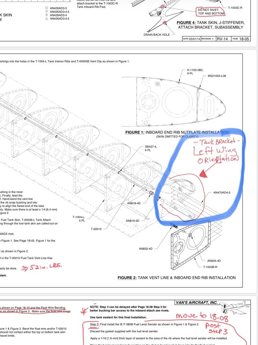

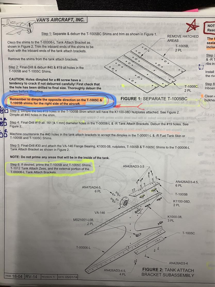

I?m a little confused by the statement in BOLD on 18-04
?Remember to dimple the opposite direction on the T-1005C & T-1005B shims for the right side of the aircraft?.
Please reference pictures below and areas denoted w/ blue outline.....
Other notes and highlights aren?t applicable .
It seems that if I have the Right Wing bracket oriented correctly in regards to the flange and bearing orientation to match the left wing as depicted on 18-06 and the shims placed to match the pre-drilled holes, then the dimples should correspond accordingly without regard to the direction of the dimples. Am I missing something in this statement?
The warning is because the parts are not symmetrical so when the part is installed on the right side, it needs to be flipped 180 degrees (the top will be the bottom, and the bottom will be the top).
If when dimpling, the builder just grabs both the parts and dimples both of them from the same side, when he fits them on the other side, the dimples will be going the wrong way.

Thanks Scott- being a first time builder, I didn’t dimple the the right side shims, as I usually work sections independently. Working independent processes,I fit the parts individually. As I placed the shims on the right side bracket and compared to the left side, it was easy to see the required “ shim flip” before dimpling.
Jt
Thanks Scott- being a first time builder, I didn?t dimple the the right side shims, as I usually work sections independently. Working independent processes,I fit the parts individually.
That is a good plan.
Most of these types of warnings are because a lot of builders who have already gone before you, did not do that......;)
