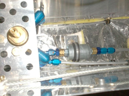

Looking for some ideas on how to mount pre-filter for EFII fuel pumps. Anybody have pictures of their pre fuel pump filters mounting and plumbing?:cool:
I re-purposed the F-1048F Facet fuel pump bracket and mounted my filter to it. The EFII fuel pump is just off picture to the right.
