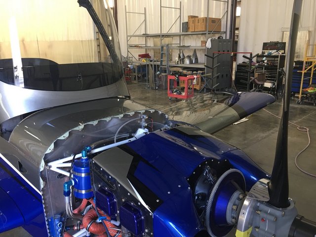

Hi. I?m getting close to the paper clip trick with trimming my RV7 baffles, so getting close. I plan to install my RV Bits carbon plenum, so I put it on the plane for a look. Love the carbon! But...the fit fore and aft is not good. Probably half an inch off. Also, there is the piece that steps out by the oil cooler brace. Not even close to fitting. Finally, where the vertical baffles bend at cylinders one and two, the carbon plenum does not match with its contour. Anyone have experience installing one of these plenums on a 7 or 9? Pics? Thank you very much!
