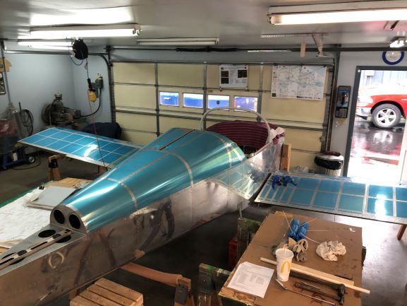

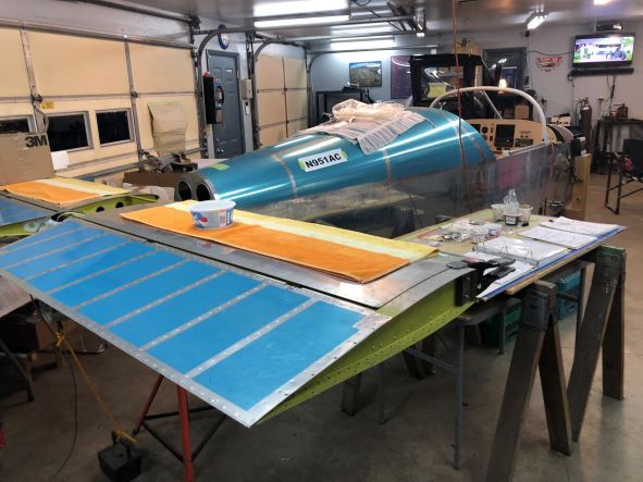

Finished riveting the top skins and J-stringers in place on the Right wing, it's a good days work to do all that riveting. Be sure to have a plan for communication between rivet'r and bucking bar'r, you can get riveters brain fade with all the repetition. Luckily nothing happened that was bad. But I did use my first Oops rivet, that was overdue..
afzqIrGDkBg2cF1TdwpJgQH8TsbfXkCNpQ2KxT4yQ3c10gS1LC3juO_1Awc5VDYD3_C4Mvyw7V5oJMt3S8SPFQhPhdeQoSyz1QxGnVf3dGIEpq-9it9BJUQiMXwZppY-rRuDBotInID4gYG7dQXsadILBkRU0peDSbUhRCR4HAeM15T_NdhEF7yWOP0_PJlH9jTsJw4VExCYvFmB3vMFnGYxA75U9I9Gy3ebHYcqi2oFrn570uHu0ub0_lS1WFl9VmcWwLtMtqGkvWRzXqBOPeWxwkRkjyaU6Hr2A6RLqUQXAoeW4RMmN0XbYlH6Ia7b8jrr_uKPFAAoyANT7nCTeWyZ62XxLicbu0jEimewtDOuO0m8vT5JLjsSL49zCkTFGyueg1tO8qN-kxztW2Zm6esmYWqzHasGCwD9BPNt-MwkRqIE-w3QgZNIBfTr1kOAZm3CaBNb4Vs3geLODuRypNAdt0je8Diao8znY48Uxtr7iXA5-FCGu12W9HnMi4nvg-6qwCkoGDk_s5Rbx-Cc1fmQ_gDN_jiS_MJCbLnFATdQ27MU4p2YkG5YP0bzRn46Rtr9tLKtB61d7Rpgz0YCh5GewZaXF00Z6aH6qnIVyhmTe44QKtDPlItUlZ3ebzlM4axvRHcFX7cdU6SjWglLgZWEZMJz9VMb=w1192-h893-no
bAxiHB6mjnyXuZ6_rbSpskQL3t1cCdRR780-ITGPqA9YDgEGWa4NVorMu0sXIAf9f5IyTrrtpFAx1kESPvys1z79Mqvl8R4rDoPu657hvU3dFqyAHbFmg6oTgr2BETGXqEu8_SZRXxQu930vzAoApdQpoiZrvBcHZxWh9RmwrLVodfTAdp1m6LOY8tLJNyBjAAAm992_pUgUKE62Kioj69l-c_eztJTgsFetJNPdznBqOmaPP2haLzBiaqoivbtqc2qbzaIUj3DMCKmzvQyyn1DurrTVWSInG6WoMFBhuuJLYqvD67aGkyiaM0NYM5RgqTUAmBeor2dI42zSAfN644A_AV29GLNjpidjpraTwF5etSWlP9pWDWCXopVK2UN6W1i8asIZhWFY9Oz0ArU4UQKW5LqWelSAKA3tjMs46WJVHicoKqgyJkfL3uStb7AXXSfb7rUQR02EbqHWSw5SdeaWK8vnnzAKASMOnIvsCKXgzNvqKWNc4E73CMkaeOKsfqwJid5pBd6UVlIxu0ou7ggt-z57J3bWpp4MokM54HWem8MOeRRWP4qoOD7QxUzpQxUWY7thEpwkJufxLhpuBXsrTUlUfc2-W8XUjvWIeCG6BxiHbjzde4FHdAPE4wBl6LZMd1PSGc4YZ0JITvqONRkwDXzt2YGy=w1192-h893-no
I'm betting that I'm not the only one that does this. Sometimes you need a little "Visual Progress", so I took an hour and sort of staged the appearance of the future final product. When no one will catch me, I've even sat in the seat and made airplane noises!

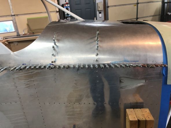

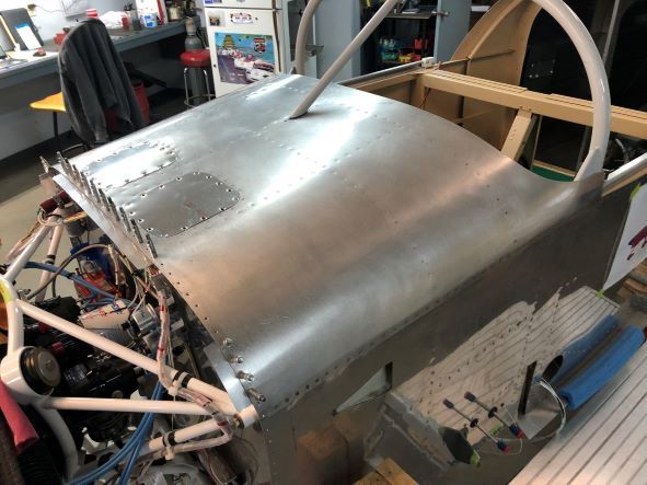

Dimples
Did you dimple those number 8 tank mount dimples with a pneumatic squeezer?
They appear to have a lot of difflection, indications of being under dimpled. Use the C frame with a strong wack with a weighted plastic hammer. Buy one of the orange ones at Harbour freight.

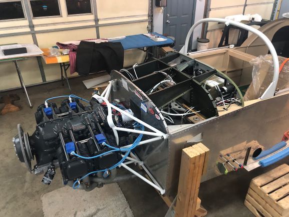

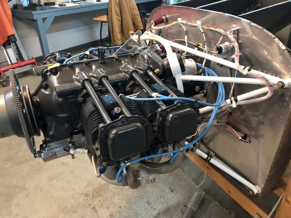

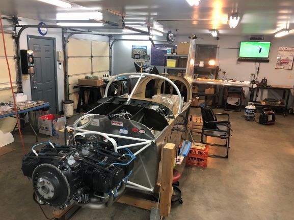

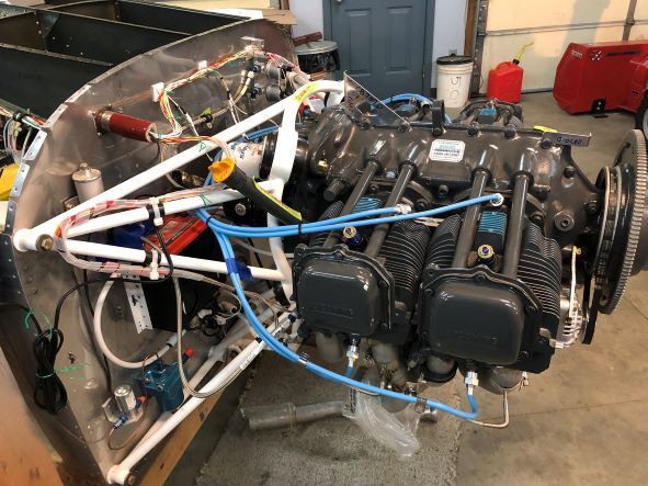

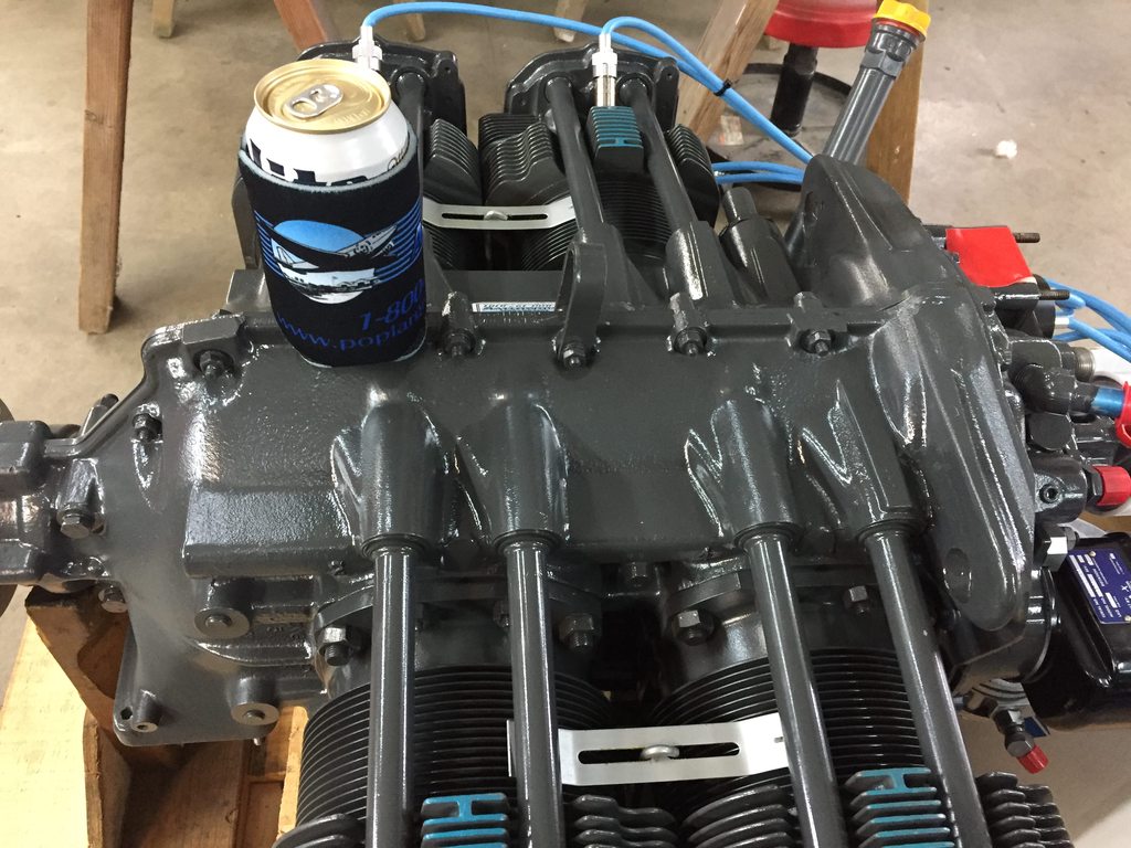

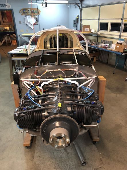

Engine is done!!
Picked up the 160HP O-320 from Poplar Grove Airmotive (PGA) at Poplar Grove airport C77 in Illinois.
The core motor I had, came with the project as I received it from the previous builder. We disassembled the motor and sent the parts out to various places, such as Divco, Central Cyls, and Aircraft Specialties. Then contracted with PGA for new Lycoming Cyl Kits, rebuilt carb, new fuel pump and other recon and finishing parts. Then final assy, and Dyno Run.
What a great job they did, beautiful work. I received status reports and pictures during the assy process, got a tour of their facility, and they scheduled so I could see the engine running on the dyno.
Can't say enough about their Customer service and quality. http://poplargroveairmotive.com/engine-shop/

That's all you need Andy! Bolt the airframe to it and go fly. Life is short so many places to visit so little time. :)
I suggest re-orienting the mags so that the vents are as close to bottom as possible. When the mags are oriented sideways as yours are, oil can accumulate since it can't drain from the lowest point. Eventually the rotor bearing seals start to not keep engine oil out. Points will get fouled and it will scare the **** out of you. Usually will happen over water or mountains.

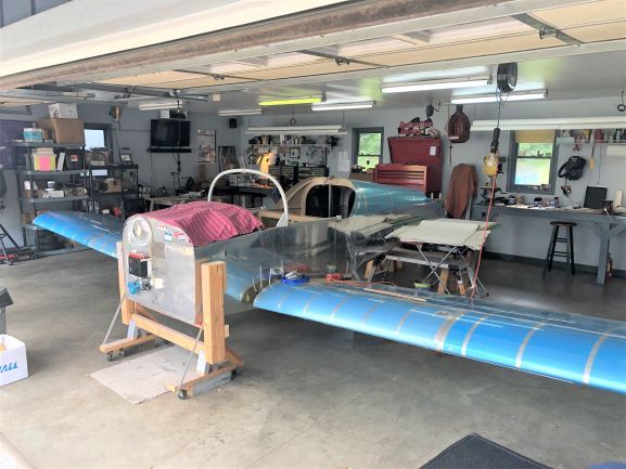

Hard to believe it's been 10 months since my last post. Here's a current photo of the Fuse. I've been working on the Canopy since early December, it's as difficult as many of the threads describe. Mostly trail and error to fit the bubble on the frame and meet the desired fit to the fuselage. I was ready to just go open cockpit, but a friend came over one day and we somehow got things fitted. (The windscreen is just sitting on the front).
YZHOo2lmvsxZovrzfVLk_K_vNP0-Hfr7EDrdDl7Jg_2zSVrAnoD0kt9IEDCpDnlbkzZvcbZRvX9ltEw3G9O99koyX1jRxGvShnadBe-WaCJ3tvsXbX7cdMeAD6-VLaPvua78t2YbclncaQ2iGcc1HI-bWInkCcdE9ZR73XnSzl1BKLbXwBkkpsf0OASSynTO5-YLw5xWKu9YVMDN44y0QlGZTuoM2OJI4DGhBi6lKtp64GoNW-wi4c6w9_sMk2cwEXc2wGLlz7BXbzYmmlTMBnnOphgO-6jy7DYYC_S0QHwT19hFyI_uW7sA9dWbSY1cvb3wGn4VMZe1ecHk8i8uTx2cPCwQ0ma2MqwEakMf1WHJdogzax88A5MsImljrSxrbu9AJal4_ADVtfX4VNaHr0sNHazOeis1B_UhJMyeUh26J7f6tJXSufBOQRYrdqHbS8VbkhggPSqIumIG_Mt_BB-auIMWF5-lqftK6VBVtM3MuAf_ohFz1TQwcWJt2tcG2wiUD0ZW_Qencso4w9ranJ1vvbm4-339HRF9q325HkL9mu3Te-mN1qnoayLOtDe6YBFS_bzYW_-fP4FNbHBZtRL4yaG4PgbokfaAyKtC0zlsgKk741bKr4tJp6vbWNen7Pv1Qoz8QE9hdY_v5EK_oNkB8C_khFsNHPUYDW1_Gbw2SiVMrkxNXThkhewz5nXuzGynJkGikxctjJL7FQ=w800-h800-no
Since last April:
-Aileron's and Flaps completed
-Riveted top skins on the fuse
-Pedal assemblies are complete with dual brakes and all plumbing
-Front fuselage frame nearly installed
-Gascolator stiffener, and gascolator in place
-Fuel tanks completed and installed on wings
-Wings completed including all wiring runs, leading edge light, and roll servo installed. Bottom skin riveting completed last week!
-Roll bar installed
-Canopy bubble fitted to frame (working on side and rear skins)
-Numerous other items....
We can roar from here I think. Aerotronics gauge panel can be installed soon. Then wings can be fitted and adjusted. We're marching toward getting up on the main gear, maybe springtime!
Empennage has been completed for some time.

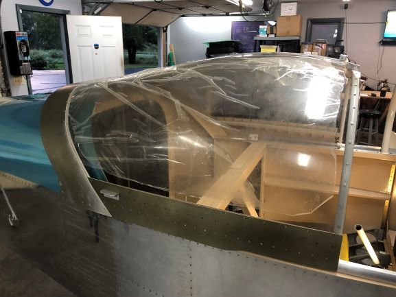

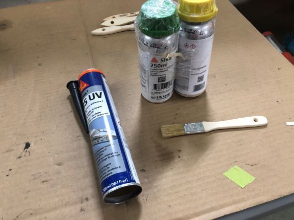

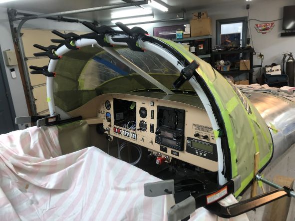

Wind screen
Have you considered using SikaFlex to install your windscreen.?
It works great and has no penetrations in the plexiglass

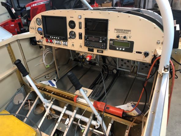

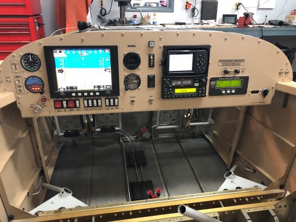

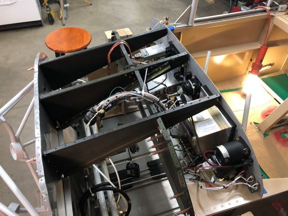

AND.... Here's the long awaited first look at the Aerotronics gauge panel sitting in place. I've waited two years to see this little gem in the cockpit. I'm betting the original builder (Marty Johnson - Gone west) can see it now, and is thrilled, he surely spec'd out a nice panel.

Whiskey Compass
Looking nice!
One tip: I'll be stunned if the whiskey compass is within 45 degrees of being correct in that spot. In fact, I've not been able to get any whisky compass to work mounted in the panel. I recently put a vertical card compass in my panel. There is nothing within 6 inches and it's nowhere near accurate.
I hope you have better luck than I. But then, you have an EFIS, so it probably doesn't really matter.

First power-up of the panel! Preliminary wiring is done, and this is the first time it had been turned on.
Nice support from Jason S. at Aerotronics. Note that this panel as built in 2010, and came with the project I took over from another builder, that was dormant for quite some time. Jason had very complete records of the panel, and took the time to answer questions and suggest go-forward plans for its installation. Great product support!
Also working to install a TruTrak Altitude Hold, and electric aileron trim.

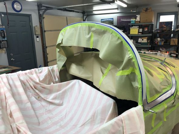

-Completed the sliding canopy (90%), what a job that was... Just need the latch installed and a couple of small things.

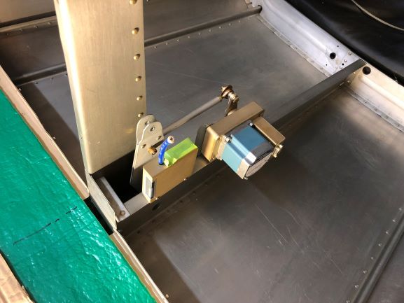

-Installed aileron trim servo and Altitude hold servo.

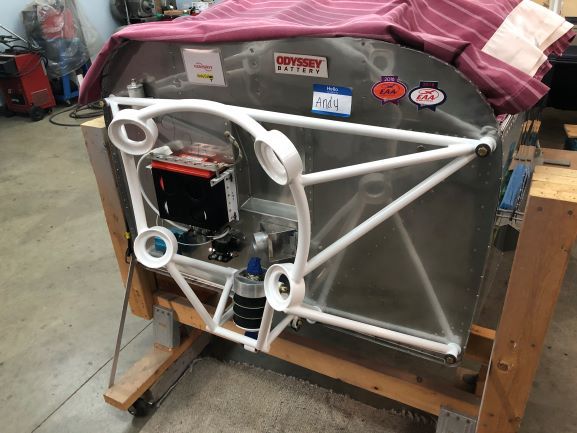

-And the exciting installation of the Poplar Grove assembled O-320. That really added some visual progress!

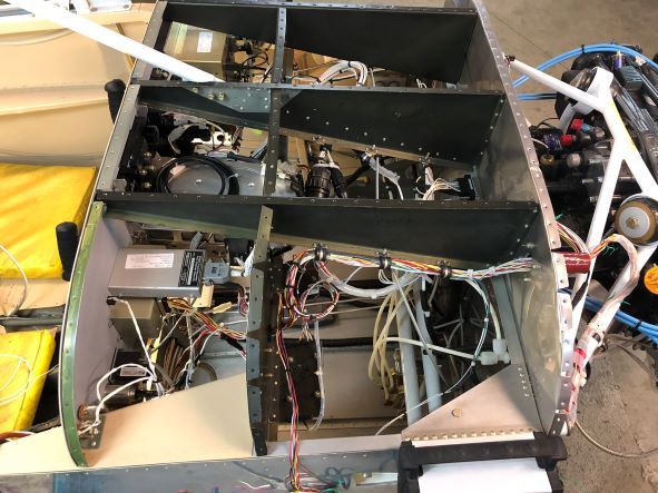

Work has continued on the 9A. We completed the fitment of the upper and lower rear fairings and removed the empennage until paintwork will start (we'll be painting the plane in my shop, but the tail, wings and fuse will have to be painted separately).
Then began the installation of some cables. Throttle, Mixture, Carb Heat, and Cabin Heat put into place initially. We've updated to the revised 9A nose gear and engine mount, no problems so far with routings etc, although if you were extra smart, you might do the firewall penetrations and some other things before mounting the engine. But it's not fatal. If you built these every day, you'd be a lot smarter. The second plane would be perfect.
Then on to wiring,,,, I don't hate wiring but I've found it to be the least documented aspect of the assembly, very slow progress, lots of head scratching.
We did at one point, fit the lower cowl to see what clearance we had for the EGT's. There looked to be good space for the orientations we had chosen.
But it's understandable due to the varied nature of each aircraft installation. I'm working from electrical schematics provided by Aerotronics with the panel that they built, and their support is amazing.
I did pick up a Dymo label maker ($60 off Amazon) and it prints on shrink sleeving. It works great.
I have found that it works best to tell yourself, "I'm going to focus on one thing today", as you do the wiring. Like, "Today I'll wire the EGT's". Small bites seem to work well, because if you try to contemplate the entire wiring job, your head will start smoking. And we know what happens when you let the smoke out!

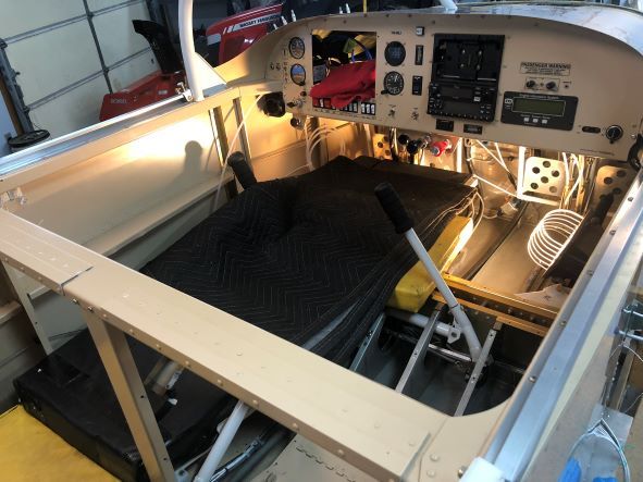

Getting closer to putting the RV-9A up on the main gear. Am looking forward to that visual progress! All FF wiring is complete, and have been testing the EIS/EFIS inputs before riveting the top front skin in place. Wiring and panel installation has been a long process.
Looks good Andy. Just doing my first condition inspection now. Finish everything possible up front before installing the top skin. After that it’s lying on your backin a dark hole. It’s really worth every minute you’ve spent on your project when you have that first flight.

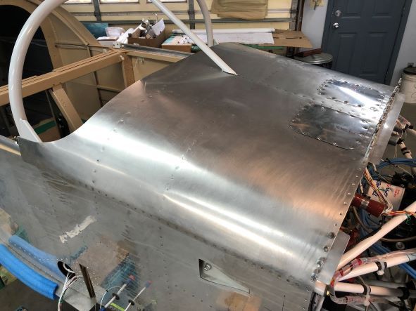

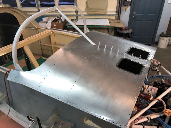

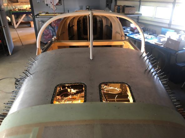

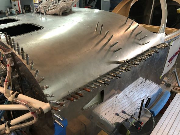

Got the point where I couldn't go any further with the build until the front top skin was riveted on. I had completed all gauge panel and under front wiring, and tested everything that I could for function, so it became time to rivet the top skin on and begin the work on the fiberglass cowls.
I had a friend helping with the under panel bucking bar work, so tried to make it as comfortable as possible being under there. I had riveted all that I could by reaching under the panel from the front, but you get to a point where you have be underneath. I had also installed the Van's avionics access panels, having only realized recently that the kit existed. Will be great if we ever have to get back in for any wiring work. It was one of the tougher skins to rivet in place, both because of crawling underneath and having to remove some things to get at all the rivets. We roll formed the skin abit, but it still required some of the higher force "Wing Nut" Cleco's to pull it to the main stringer. I did use a couple of pull rivets where it was impossible to get a bucking bar behind.

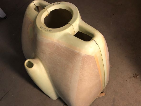

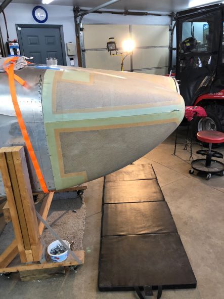

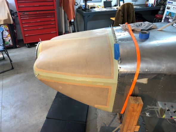

I've also started the work on the fiberglass cowls. I have a set of the older "Green" cowlings, as the FF kit is from around 2005 by the records. I bought the project from a previous builder's estate. I studied numerous on-line builder logs, the Van's instructions, and anything else I could find, and dove in. I decided on the Skybolt fasteners and am progressing with them. The cowls have had the first trimming done to the firewall, will continue from here!

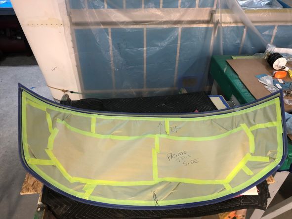

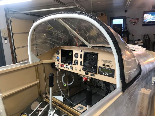

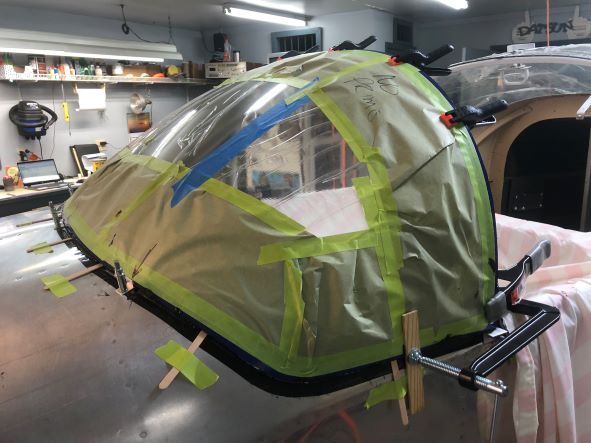

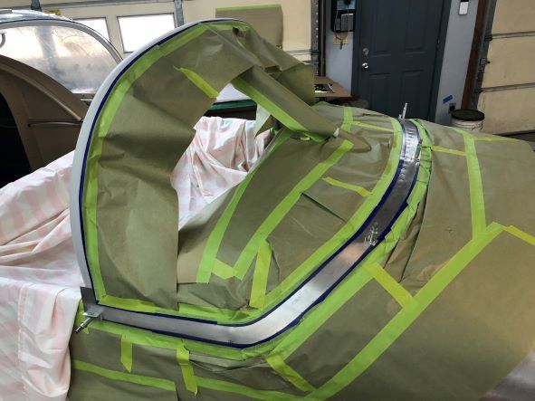

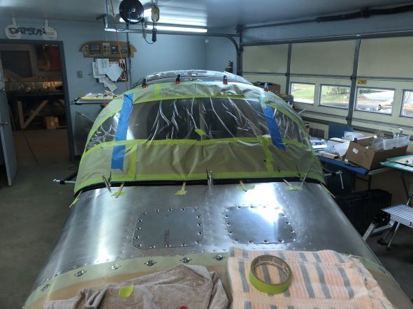

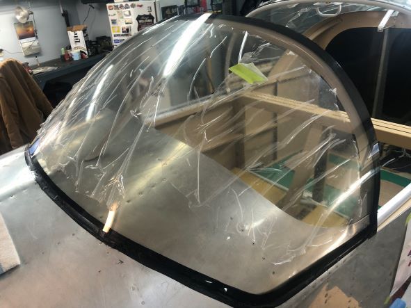

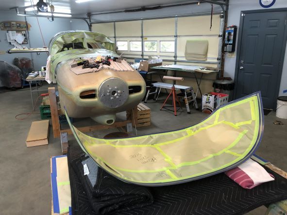

Working on the windscreen installation. Lots of trimming of the plexi from the Big Cut, but eventually it was ready to install. After lots of review, I decided to use Sikaflex. My opinion is that it's not very difficult to use the materials. Just takes some care to place and hold the windscreen while setting up, and to be neat with the application. Thanks to the builders that have made video's and written posts on how to do this, it sure helps to have them for review! Next step is to create the windscreen frame.
So fast forward to March 2025… N951AC is in a hangar at KAZO Kalamazoo, Mi and is in review with the FAA for AWC.
Much has transpired since I last posted an update. Too much to type about here, but I’m planning to do a YouTube video soon, just have been waiting for warmer weather up this way.
With luck the FAA inspector will return from the GR FSDO yet this week or next depending on his schedule, to review completion of several minor squawks, and issue the AWC. It’s been quite a project, let’s get her in the air!

First flight was achieved on July 10, 2025. So far we have 12 hours completed of the required 25 hours of Phase 1 flight testing specified in the Special Airworthiness Certificate. So far we have had no significant squawks.
Currently we're working on vinyl wrap of N951AC. I contacted a local company with experience in many types of Wrapwork, and we are nearing completion of the project as flying weather has diminished somewhat up here in Michigan lately.
I'll be making a video of the Wrap process and final product when complete, for now this is the progress to date.
