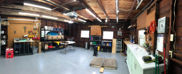

Workspace
We put some nice lighting in and started getting tools setup.
We coated the floor to make it a nice space but sadly that crack in the center of the foundation reappeared and I just had to move forward.
Built the c-frame table but we didn't have anyway to rip the boards to get the right height so we had to improvise and add a plank under the c-frame. It seems to work!
