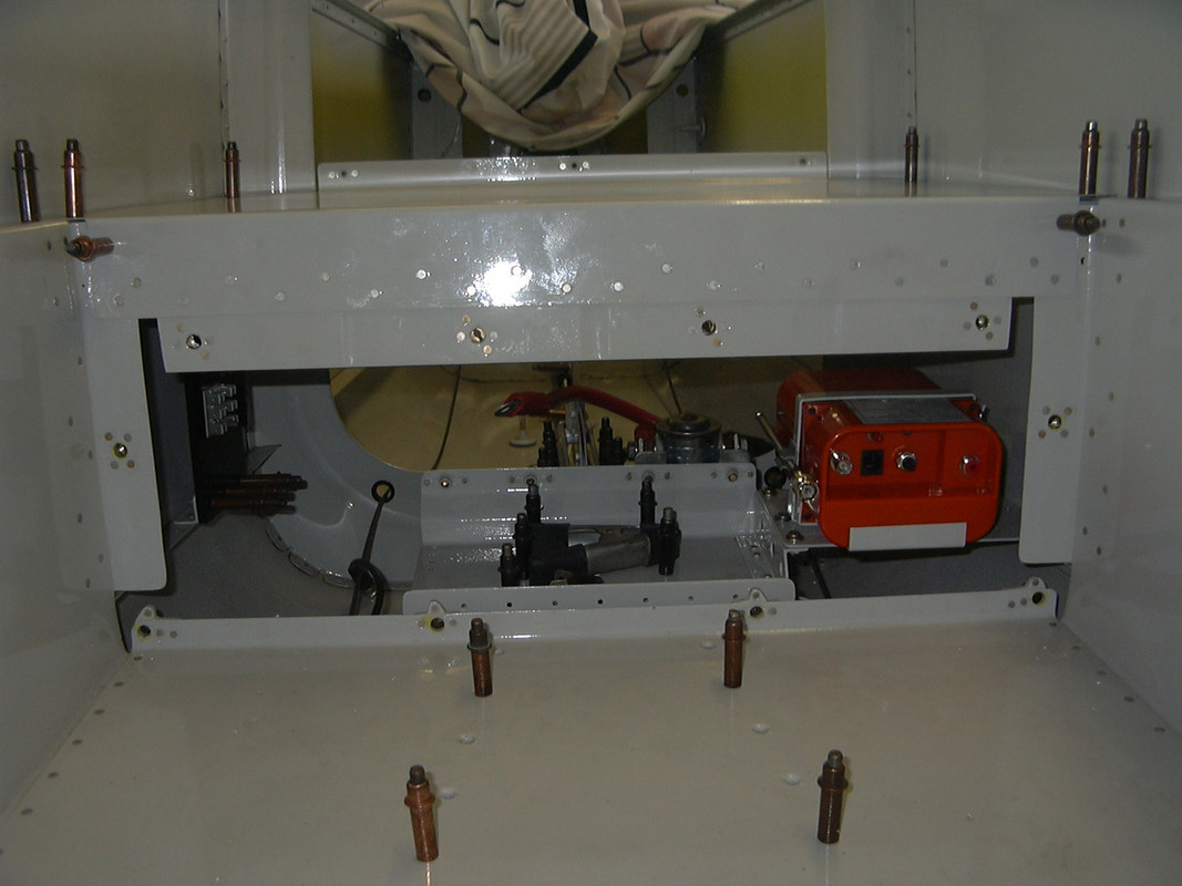

Twenty years ago when I built my -8, I sort of pioneered an access door for my rear mounted batter in the “hat shelf” of the baggage compartment. It’s too small becasue I built it with “scrap on hand”. I am now building a Rocket with essentially the same baggage configuration and rear mounted battery, and would love to see pictures of everyone’s battery access doors so I can steal….uh….learn from what others have done! All to avoid removing ten #8 screws to access the bellcrank/battery/pitch servo….

”stolen” from here…………
i think it is perfect.
i formed a loop at the end of the pin, put in a nutplate and secure the entire thing with a screw.
Remove 2 screws, pull the pins out, remove hatch. 30 seconds, full access.

I can access the front or top of the rear shelf or take the panel out. The frame around the opening is angle to make the shelf stronger. In hindsight, I should have used camlocks. The bulkhead is a door with camlocks that lays down so I can fit something long or light items.

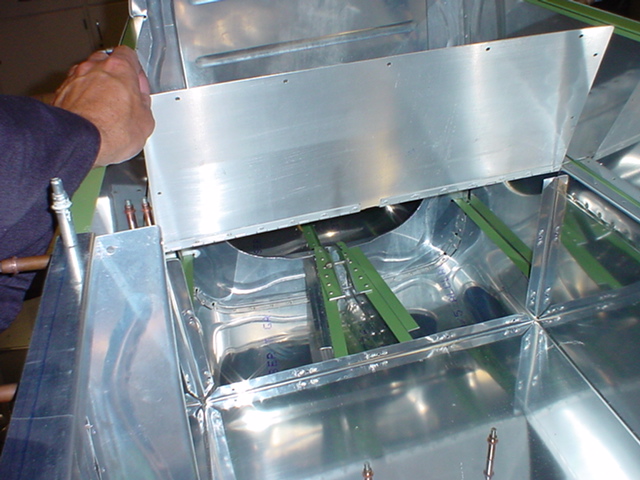

Got this idea from Dan Horton:

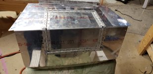

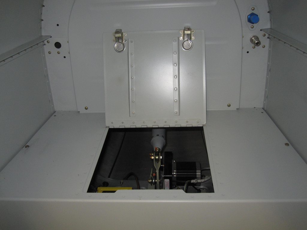

I used a laminate cutting blade in a utility knife to cut the access doors for battery and ELT access in the baggage shelf by making multiple straight scoring cuts in the aluminum. This allowed me to use the cutouts as the doors so I didn't have to make them from scrap pieces. Plus they fit perfectly. I used scrap aluminum to make support flanges and rolled one edge of the two longer battery hatch flanges to add stiffness. Added piano hinges and Hartwell latches that I bought used.

I would like to do something like this to make the battery easier to get to, but I'm concerned with structural weakness.

I studied your pictures carefully. I take it that the structural support that the un-modified baggage shelf provides is for and aft and now side to side?
You will need to ask Van’s, but my understanding is the baggage shelf is considered structural.

Check with Van's, but it can't be carrying any significant structural loads. It's installed with AN515-8R8 screws on about 6" spacing. I'd guess its function is just to prevent baggage getting into the tailcone. If so, the simple door shown in post #8 is probably all that is needed.

I simply hinged the front wall of the battery compartment cover. Use another piece of hinge in lieu of the screws if you like and you'd not even need tools to get in there.
