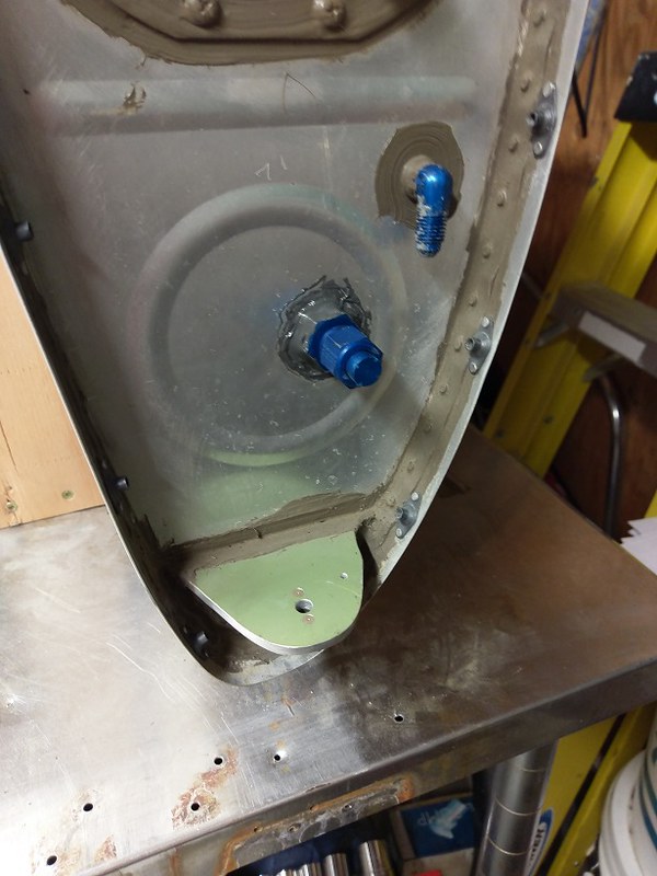

I think replacing that Z-bracket would be a beotch! Okay, not that bad but I wouldn't want to play around with more proseal if it wasn't necessary. I think I would fill the holes and move on. With this one being on the inboard end I might also send an email to Van's but I'm betting they would say the same. Never know though I guess.
Heck ya dude!
I will call tomorrow but I have already decided to fill them. This wing has some hours on it and I don't see and cracking of any kind. I might put a backing strip on it all the same and go up a bolt length. If I rivet it on and get it nice and centered I think I'll be good. I have a bunch of wiring done Jereme...I don't have pictures yet. I have realized that if you buy premade cables they have outer insulation and they seem pretty sano.
