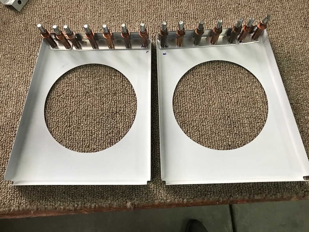

Recently did this for Garmin 10" displays:

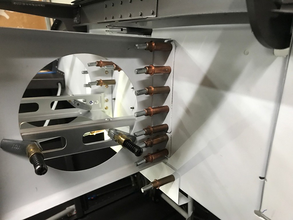

Cut the ribs and made some attach angles. Note there is a very slight bend in the subpanel here that I wanted to preserve, hence two angles per rib:

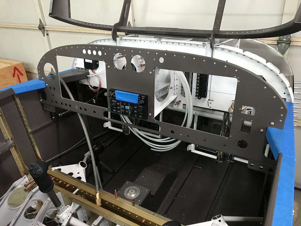

Drill/Cleco to subpanel. See the radio mounting bracket in there which determined the new distance between the ribs:

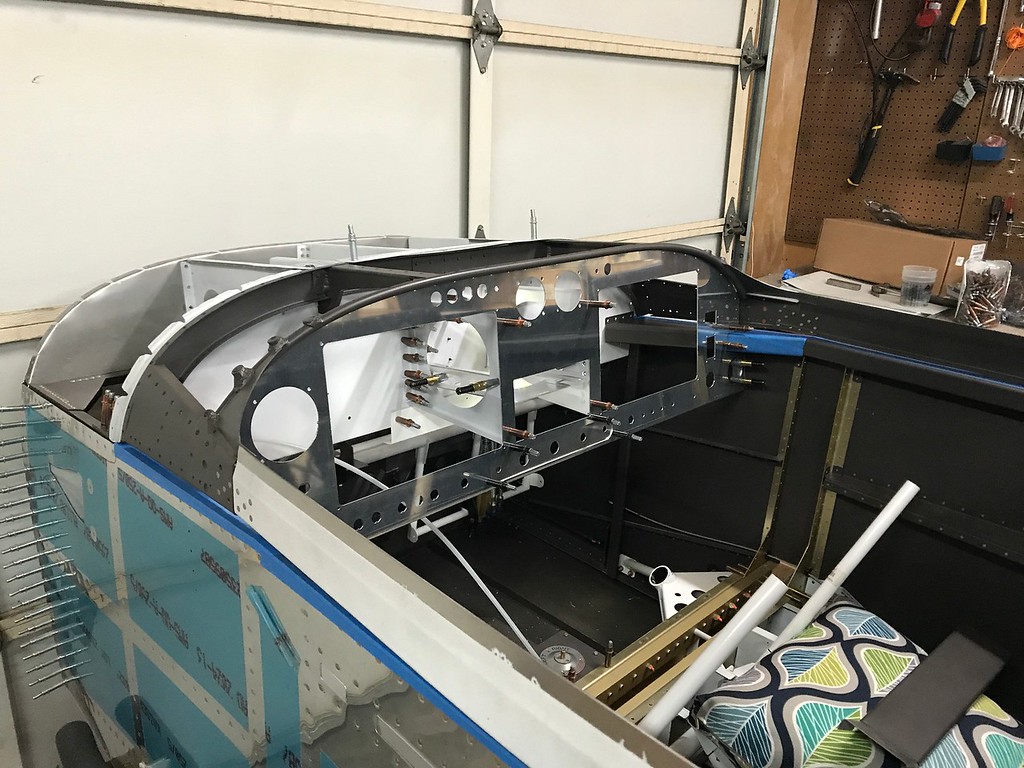

Test fit the panel:
After riveting, everything fits!
What distance from the centerline of the panel did you use to save room for the center stack?
According to my CAD design, the inboard faces of the ribs are exactly 6-11/32" apart. The Garmin radio installation sled is approx. 6-5/8" wide. I didn't final drill the ribs to the subpanel until I was able to test fit with the actual installation sled.
