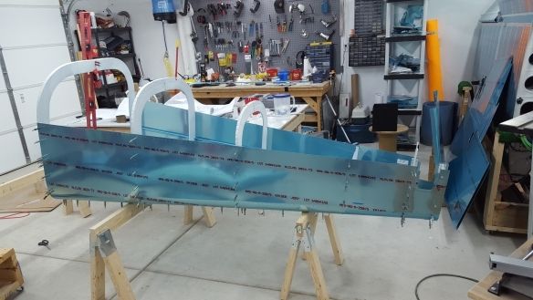

Details on the mods

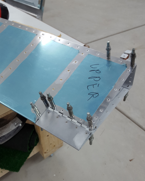

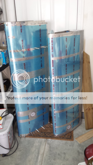

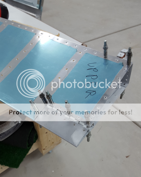

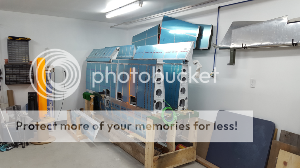

This is the trim tab on the left aileron:

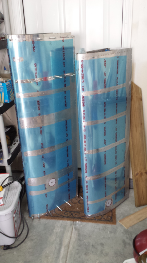

And here are the fuel tanks for the left wing. On the outboard, fuel is in the area that is riveted. I also put non-locking SPRL caps on all four tanks.
Started riveting the firewall this afternoon.

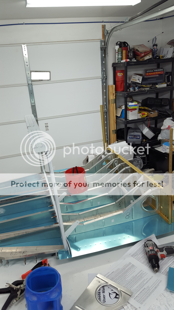

Now, back to the fuselage frames (currently drilling and deburring the baggage bulkhead), then painting them.

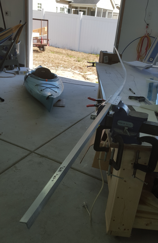

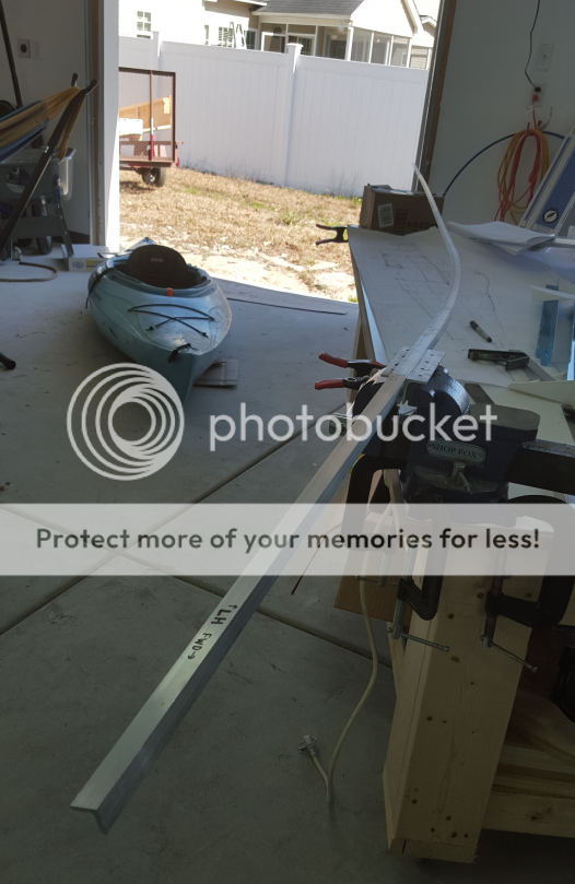

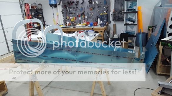

If you start with what will become the top surfaces of the longerons clamped together, you can put the long curve in both longerons at the same time, and you don't need a hammer or dies, just a vise. Having the longerons clamped back to back prevents the out of plane bending problem you get when using the hammer method.

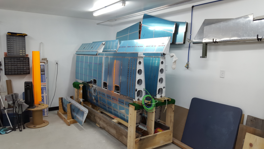

Got some coworkers over with promises of beer, and we mounted the wings last week.
Today I checked rigging.
Incidence is a hair high (bubble is touching the forward mark) but it's even on both sides, all the way out (no twist).
Edge distances are good.
Triangulation is dead on to 1/32".
Both wings are swept forward 3/8" at the tip.
The flaps touch the bottom skin perfectly.
Close enough for government work!
