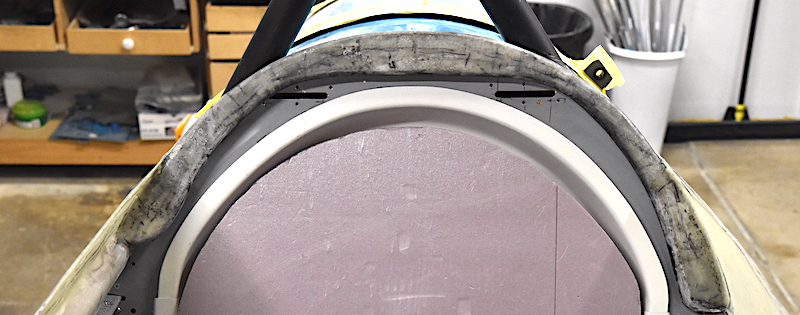

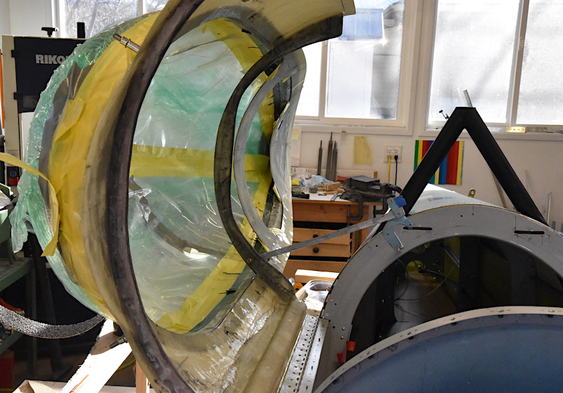

Since the first inner flange was unsatisfactory, I made another one. Here it is, still in the canopy as laminated. I?ve removed the peel ply but haven?t separated it yet. I hope it's not too thin....

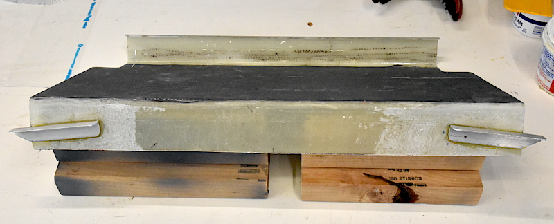

The inner flange has been removed, marked and trimmed is ready for prep for the bond.
In the meantime, I thought that you might be interested in the maintenance manual that I?ve been preparing. When I come across something that seems like it?s worth remembering for future maintenance, I?ve been jotting it down, along with photos. At first it was all in one manual but the organization got unwieldy, so I separated it into chapters. At the time, I was using the Mac software Pages. More recently I changed to the free open-source Office-like package, Libre Office, which I like a lot. Hence the ?.odt? suffix.
I finally got the inner flange glued to the canopy and outer flange. Here?s the stack curing. I clecoed it down to ensure that it doesn?t warp. I used 2216 for this bond because it sticks to the canopy.
Although the fairing is in place, that?s not part of this bond. That?ll come shortly. I knew I wouldn?t have time to manage that joint, too. It's there to give me something to cleco the flanges to.
Dave
Before I went to bed that night I glued the inner flange on, I pulled that green electrical tape off on the inside. It’s purpose was to keep the black sticky 2216 glue off of the canopy. The glue had flowed over the tape, not unexpectedly, and there were some glue tentacles that remained as I pulled that tape off. I tried to keep it off the canopy but was unsuccessful. It was still in a state where its adhesion was greater than its cohesion; I couldn’t pull it off the canopy where it had touched. I went to bed knowing that I’d have a real problem.
When I got the canopy back upside down the next morning and had a look inside, I thought that maybe I could grind the epoxy off. Yeah, that would work, sort of, leaving a lot of polishing ahead. But the glue hadn’t completely cured. I could sand or file it, no problem, but an Xacto chisel blade was able to remove it. In most case there was no residual mark. I was so lucky. Problem solved.
On the flanges, though, it wasn’t so easy. The canopy itself had been unprepared where I removed the excess glue from it. The canopy flange was fiberglass and had a roughened surface. The 2216 didn’t come off there. For those, I’ll have to grind them off.
3M’s 2216 epoxy really does a good job of sticking to things.

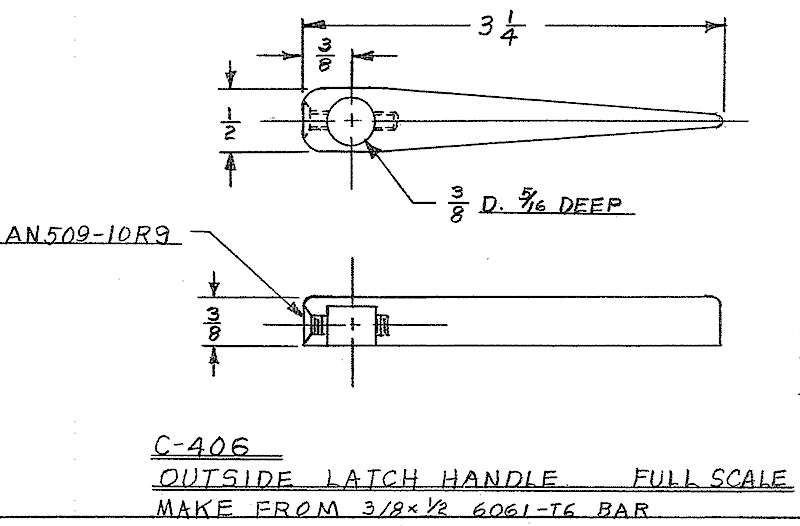

In case you’re wondering how the flanges and the canopy all go together, here’s a sketch that I made. The flanges are rounded at their apexes but that’s a bit hard to do with my drawing package. You’ll have to imagine that for yourself.

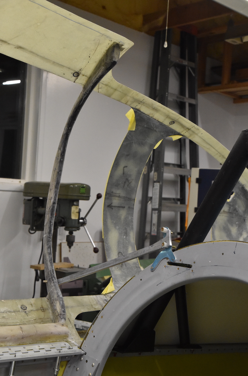

The canopy latch handle is located - hope it’s in a decent position. The aft canopy latch, at the aft most end of the canopy, is operated by this. The actuation rod is shown here with the latch handle. The bend closest to the latch is undergoing several tweaks and this is not the final version of that. The rest is, though.
It continues outside the cabin but inside the canopy. The red circle closest to the cockpit marks where a guide bushing will go, and the rod itself will engage a standard eye-bolt in the fuselage that pokes through the canopy fairing at the red ellipse.
Fortunately, I realized that I needed to set this up before the canopy is bonded on. There’s not room to access it later.

The forward-most guide flange was made in two passes plus trimming. I wrapped a foam block in packing tape and taped it to the fairing. Then I made a fillet of flox and laid up six layers of BID.
With the block removed and the flange and fairing sanded, I made a similar fillet and laid up four more layers of BID for the other side of the flange.
Finally, I trimmed it. I keep a set of washers of various sizes handy for use as templates for different sized curves and used one here.
The bushing needed to have an ID of 5/16” and that’s a size that Van’s doesn’t sell. But Grainger does, and the bushing is now in place. And yes, the flange clears the canopy.

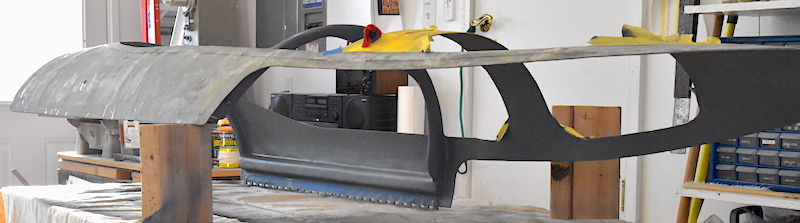

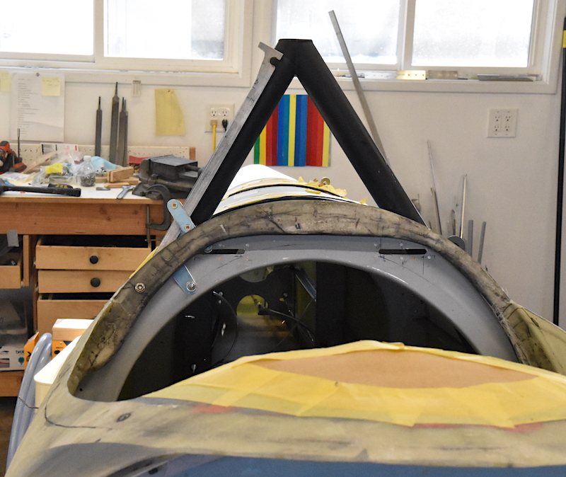

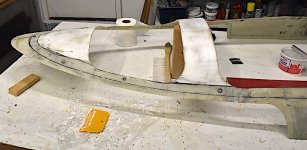

Canopy Fairing Has Its Hinge
Life has caught up with me again. Here and there, I worked a few moments at a time. Sometimes I was delayed for parts, but most of the time it just happened.
Well, enough whining. Here’s what’s been done.
I disassembled and then reassembled the latch mechanism, after lightening it up a bit. Flight hardware this time, etc.
Shifting back to the fairing, I applied micro to the top inside of the fairing, the places that would be at least awkward to get to, and perhaps impossible, once the canopy is on. Here’s a pic of the aft most two sections with the micro on. I might have been a skosh lavish with the stuff.
After sanding, well, after considerable sanding, I gave it a shower. Feel free to look away if you’re a sensitive person - here it is in the shower, posing. It’s not the least bit shy.
Since it was both simultaneously too warm and not humid enough to spray the Ekopoxy primer that I’m using for the interior, I needed something else to do. What I did was drill and cleco the canopy hinge to the longeron and to the fairing. With it all clecoed together, I could do something so basic and so important it could have been a milestone all by itself: I opened the canopy fairing. And hey, guess what? There’s no way to hold it open yet. Plus it’s about as floppy as a newspaper in a spring breeze. While I know that the canopy itself will stiffen the assembly, what I need to do is build a frame. The basis for it is in place, a stiffener just above the hinge.
Here, the fairing is resting on the roll bar, not a permanent rest for it. You can just barely see the stiffener inside the fairing near the hinge.

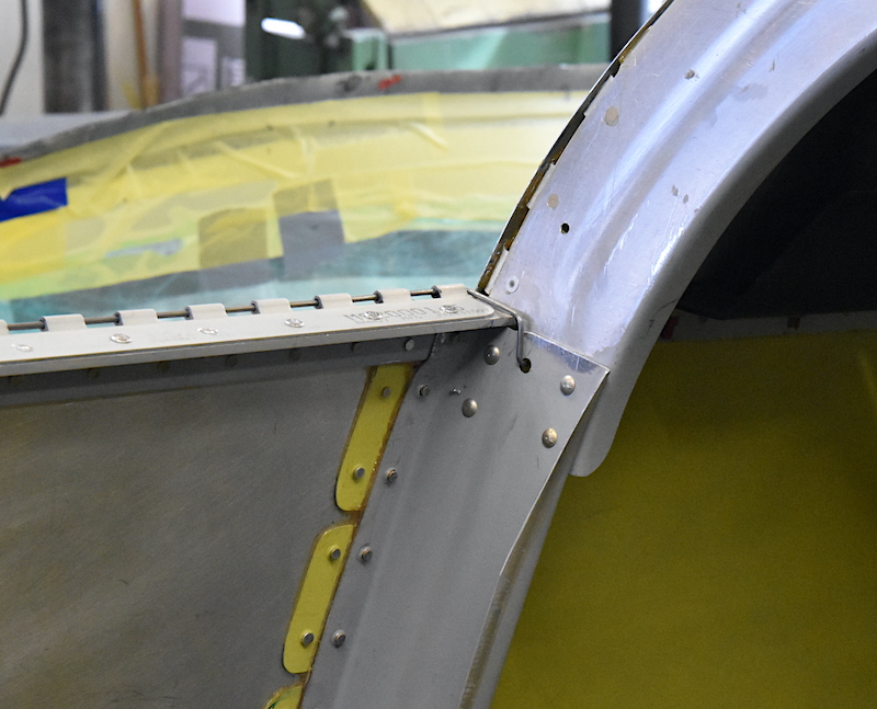

There are some considerations for the hinge worth noting.
1. There needs to be a way to remove the canopy and fairing and frame from the fuselage. Somehow, that hinge pin has to be able to be removed. What I plan to do is at the aft end, bend the pin inboard, then down, and finally aft, where it should rest in a tooling hole in the seat bulkhead. That’ll secure it when I don’t want it removed. When I do, I’ll pull it around and slide it out of the hinge aft-ward.
2. The hinge needs to be slightly outboard of the longeron or the fairing/frame will bump into the side of the fuselage. I did not allow for this when I made the fairing, but it’s sure as heck included now. It would have been easier to do it earlier, and the manual even mentions this, too.
3. There needs to be some sort of weather protection at the hinge, lest the cockpit flood. That’s TBD but shouldn’t be too hard.
Not precisely part of the hinge, but there also needs to be something to hold the canopy open, as I hinted above. Ideally, it should be incorporated into the part of the frame that I still need to build at the seat bulkhead. Some people attach it to the roll bar but I failed to provide provisions for that when I built it, and am reluctant to retrofit that now. Have ideas but haven’t settled an an approach yet. But I have ruled out a cord/cable/rope/chain/etc. in favor of something which will provide a positive stop. Right now I’m thinking of either a folding strap latch like some people have used or an air spring. Or something else, and yes, I have something in mind that might work, but probably won’t.

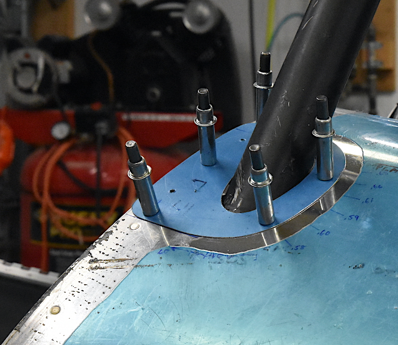

I should probably mention that after consulting with Van’s Support, I’m using LP4 rivets for the hinge to longeron joint roughly per the RV-4 Preview Plans. For the hinge to fairing/frame, I’m using AN426AD3 rivets and am gluing the hinge to the fairing/frame. The rivets here are per Drawing 33.

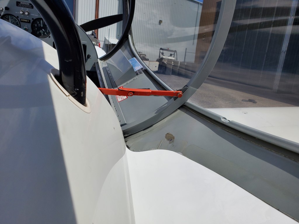

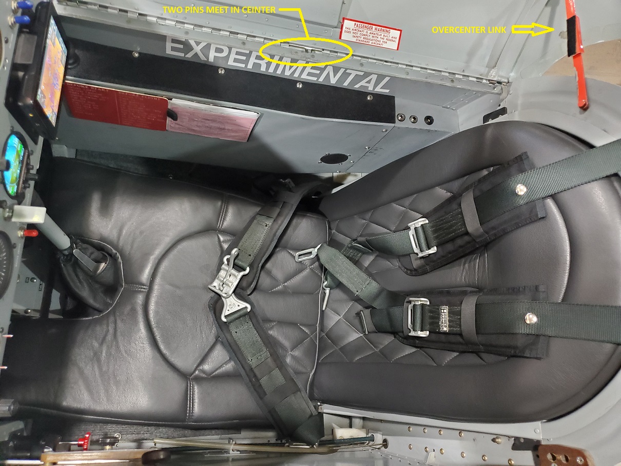

Dave,
On my RV-3B the canopy hinge had two pins that inserted from the center of the hinge outboard, each. So the bent end of each pin met in the middle. I think one of the hinge bulbs was removed where they came together. So instead of one long hinge pin accessible from the outside the two shorter ones were accessed from the inside and there was less alignment and friction problems than on long pin. And no hole or other access feature was needed on the outside to accommodate pin insertion/extraction.
This is the same concept used on many of the seat back hinges where there are two pins on the seat back hinge, each pushed from the center outboard for half the hinge line as it would be impossible to insert one pin without there being a hole in the exterior skin to compensate for the straight length of one hinge pin inserted from the side.
Also, my canopy hold open device was an over-center link that folded from the center up. When in the pilot's seat I could release it with my elbow. It did a good job of holding the canopy. It was attached to the seat back bulkhead rather than the roll bar.
Jim
Thanks, Jim, I appreciate the pics.
Having just put the pin in today, fighting it the whole length, I might go for the split pin arrangement. Have to say the whole length one was a pain. Confirms my plan not to use piano hinges for the cowl.
The hold-open arrangement you use is one of the three most likely options I'm considering. The other two are a different sort of folding strut or an air spring.
Dave
Don't be too quick to write off the use of piano hinge for the cowl. I had the fancy quarter turn fasteners on my Midget Mustang. They were heavy and expensive, but they worked VERY well.
My RV-3 has hinge pins for the cowl at the split, top-to-bottom, and at the firewall on both the top and bottom cowl and I've come to LOVE them. The original builder did a fantastic job of making sure everything fits and the hinge pins aren't being used to tweak anything in place or suck anything in. He also included some bent needle nose pliers that have a hole drilled in the jaws that fits nicely over the hinge pins to aid in removal and installation. Next time you're up flying, plan to come visit me at CO12 and we'll remove and reinstall the cowl. I've become quite proficient with the recent engine rebuild. I'd fly it over to Boulder, but I'm out of service right now because my prop needs to be serviced.
FWIW, the Glasair 1RG I recently purchased also uses hinges for the cowling and I'm very happy with the arrangement.
If done right the hinge pins on the cowl work fine. My RV-3 had a little piece of hinge to retain the bent pin handle at the front of the cowl. My RV-8 has pins that are inserted from the cockpit side so the exterior hing line is smooth and pin is hidden. That requires a longer pin with nylon tube guide to keep the pin aligned when inserting. Nice and clean but more work.
If you go with Skybolt / Camloc type fasteners you might consider leaving them loose without retainer washers. While you will have to put them in a cat food can when taking off the cowl they won't fight you like retained ones can do while you try to pry off the cowling and all the little lock pins are catching in the holes.
As far as canopy hold-open devices go, I like one that doesn't impose a bending load in the canopy when closing it like an air strut can. With the mechanical folding link there is zero resistance when lowering and no twisting load on the frame in either direction. Not saying an gas spring would be a no-go, especially if a lower design pressure than normally used in automotive and commercial applications.

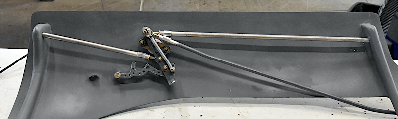

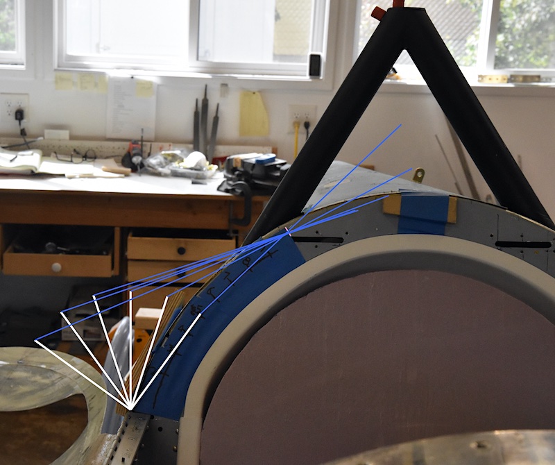

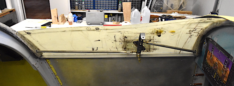

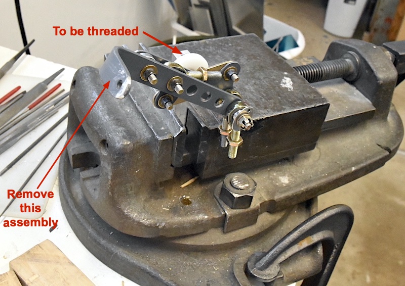

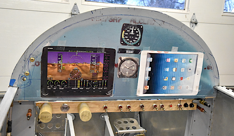

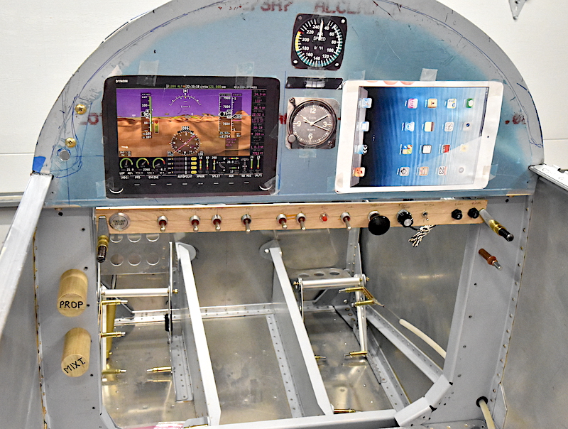

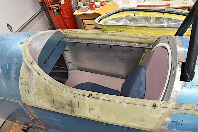

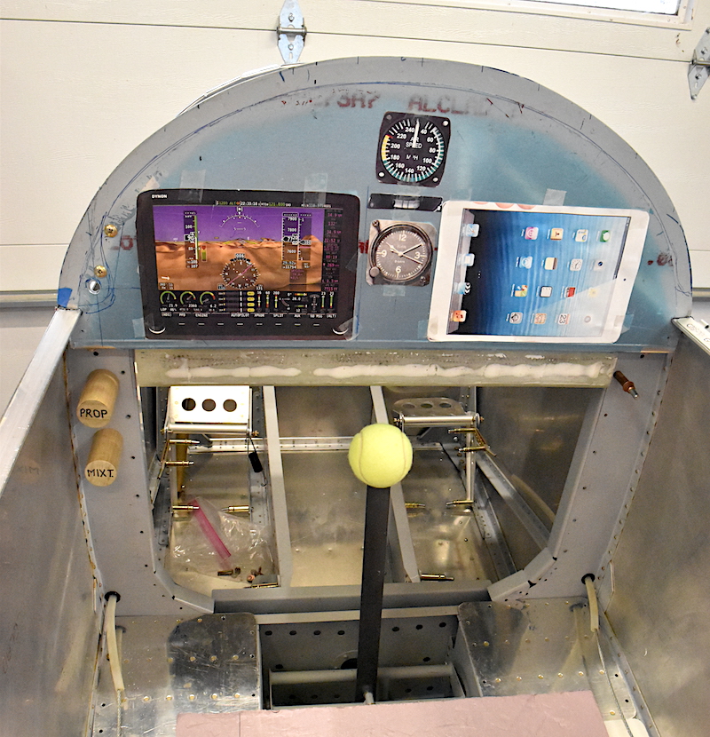

Although the canopy still isn’t on yet, it was time to get an idea of what sort of geometry was available for the canopy frame cross-stiffeners (the ones front and back that go side to side). These are going to be foam core, fiberglass and carbon. Here’s me with a 1.5” cushion under me and a 1” cushion plus a 2” foam spacer for the seat back. With my age and the pandemic, I let few visitors in to the house but with the garage door open and makes all around, they can come into the garage. One took this photo.

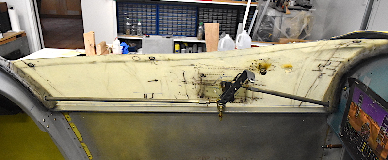

The c-clamp was holding a dummy cross-stiffener in place at the panel, something to give me an idea. But the main thing was all the space I have between me and the seat bulkhead. Some of that can go to the cross-stiffener and some to the hold-open device. And that design is being narrowed down. A possible idea that I hinted about earlier won’t work but another might.

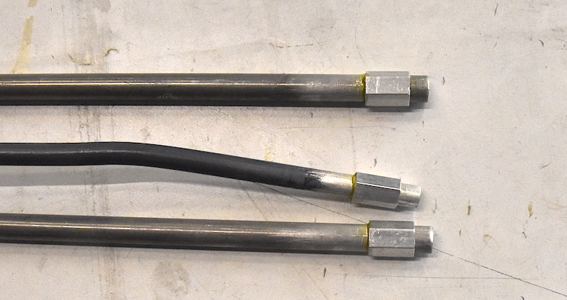

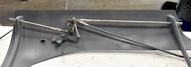

The latch assembly has the usual forward and aft latching bars. I’ve added an aft-canopy latch point, remember, so I have two of them. In an effort to minimize the build-up of friction, these bars attach to rod-end bearings at the latch itself, and those will be secured with jam nuts. There are other ways to do that, such as small holes in the bars and safety wire around the rod-end bearing pins, but I’m comfortable with this.
The next issue was how to hold the rods while gently tightening the jam nuts. The approach I chose was to get some aluminum hex bar and drill it out and glue them on. VAF member Rick Brennan kindly did the drilling on his mill. Thanks Rick! Here are the rods and the bit of hex, which is only to hold the rods while snugging the jam nuts.

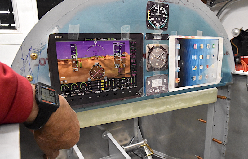

Here’s a quick look into the canopy-less cockpit as I had it at one point. Before too long, I removed the 2” foam spacer under the seat cushion but who knows - once the canopy is on I can play with that. Also the cushions are not RV-3 cushions. They were made for a different application all together, and I’m merely re-purposing them, to use a semi-dumb word. After this photo, I added another, final, coat of the dark gray interior paint.
Some cockpit work needed before flight.

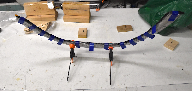

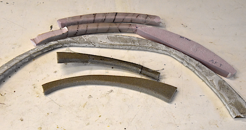

The top two pieces used the foam I was planning on using for the front cross member, 2 pcf construction foam. The bottom piece is a sample of the 5 pcf PVC foam aft cross-member foam that I’d tried to heat-form and got too hot, while the piece above it was a trial piece of the same foam that I’d wrapped with 45 degree BID, with the glass wrapped along the bottom and along the top. The top two pieces and the middle piece were spiral-wrapped with 90 degree BID. Unfortunately the wrap wasn’t at the 45 degree angle and I couldn’t make it so.
The middle piece wasn’t intended to be practice. It was supposed to be the beginning of the aft cross member. But the lay up was also sufficiently uneven and in places not attached to the foam core so I scrapped it.
This attempt did use heat-formed PVC foam. I formed it to be parallel to the seat back on the right but 3/4” away for that hold-down bracket, and within 1/8” on the left for the latch bar.
The one I was working on today merely goes from one side to the other with those spacings, no bend needed.
Once I got it covered with 45 degree BID, I applied some carbon. Here’s the first pass on that going on. So far, this will fly. I’ll let this cure and then do the edge that’s on the bottom in the photo, to build up bending stiffness.
Dave

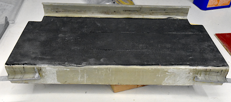

Got the aft cross-brace glued in but not yet tabbed with glass to the fairing. As-is, it significantly stiffens the entire fairing/frame assembly.
The front cross-brace has the carbon on the outer surface only so far, and that surface’s +/- 45 degree plies. It’s lagging the aft one but coming along.
This period I’ve been taking some time off work because I’ve been going down to the airport and flying. I have a Cessna and finally the wind is less and the forest fire smoke has gone, at least locally, and it’s pretty nice. It’s a curious position - whichever plane I’m spending the day with, the other is getting shorted.
Dave
The forward cross-bar has all its carbon now and is done. What's interesting to me is that the two cross-bars have carbon caps top and bottom and that's the only carbon I've needed for stiffness so far. I bought a lot more than I ultimately needed.
This has been slow going. I'd add some glass or carbon, let it cure, and it takes the better part of a day before I can work on it some more. And there's been a lot of thinking in between actually doing things.

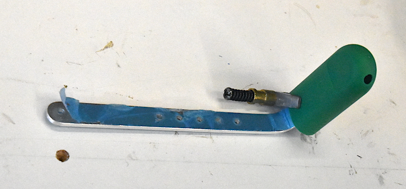

I've been working, even more slowly than normally, on the hold-open latch. The basic concept is simple enough. In this photo, the retainer plate on the front of the stop is missing but you can see the two white bushings and their screws that it attaches to.
To unlock it, merely lift the bar and close the canopy. That part works just fine.
There's a bit of some eccentricity at the outer connection to the bar since it not only pivots around it's attachment screw, it has a small rotation about a yaw axis as well. That is accommodated by a slightly oversize hole in the end of the bar. That part also works just fine.
So what doesn't work so well? The bar itself rotates to a more vertical position as the canopy closes and the bar's inboard tip moves aft. It contacts the roll bar. I've been tweaking things to prevent that and perhaps the next posting will show more. At the moment, having dropped and lost one of the only two white bushings that I have, it's disassembled.

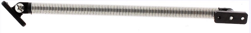

gas strut
Dave, did you perhaps consider a small gas strut to hold open the canopy? It looks like some hours have already gone into creating the latch. Just a thought, when I saw it. And I guess whatever the solution it will need to allow the canopy to zip off per Vans design if it ever accidentally opens in flight.
Paul, that was one of my first ideas. The other was a tape-measure tape used as a folding strut.
I decided against the gas strut partly because at that time I couldn't figure out how to connect it to the fuselage and partly because I was concerned that it wouldn't break free if it needed to. Now that the canopy frame is further along, I can see ways to attach it; the breaking free issue is probably minor but remains.
I bought a tape measure and tested the tape. It would not support the load intended for it. Also, repeated folding of the tape let it take a permanent set, making it even more buckle-prone. A further problem was that the mounting points would have needed to be carefully oriented so that the folded tape didn't interfere with either the canopy frame or me. While the idea has merit, the execution would have taken more time than I was willing to spend with it.
The current concept has a couple of break-away possibilities. The first is the guide bushings and screws at the top of that small bracket. They are #8 and cantilevered from the bracket. The second is the bracket itself at its attachments to the bulkhead.

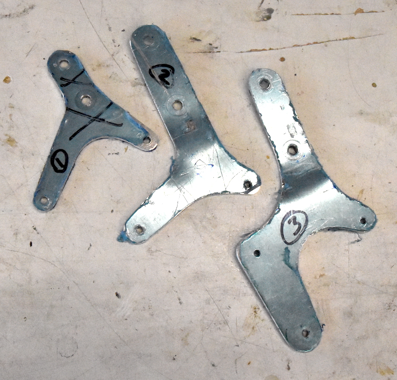

Here's the final version of the hold-open latch. I still need to trim one leg of the bracket where it touches on the shoulder harness slot. I clecoed the canopy on just to get a feel for it with that, plus notice that bit of blue tape? To see if that touched the canopy. It didn't. In the open position:
And in the closed position, this time with the canopy removed.
Here, the latch arm doesn't interfere with the canopy. It did with the prior version. As it is right now, it works quite nicely, latching by itself when the canopy is opened, and by lifting the latch arm, the canopy is free to close.
The biggest changes as this evolved were the brackets that go on the seat bulkhead. Here is the evolution, from #1 through #3. Number 4 is the current version. Each tweak got me closer, although with #3, the poor canopy would touch the latch arm, so I had to tweak it one more time.

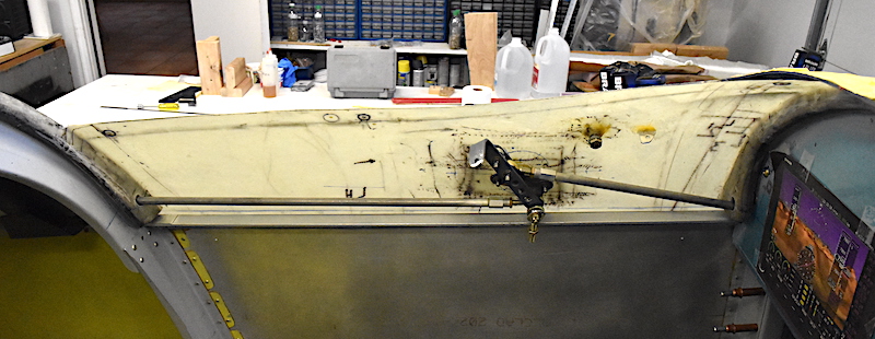

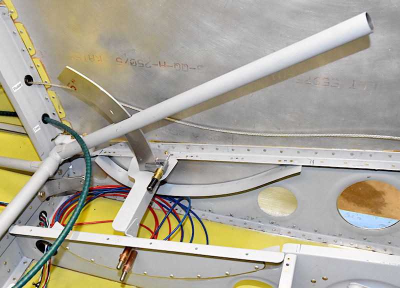

The main latch bars are now drilled through the frame to the fuselage. Since these photos were taken, I bonded brass bushings in to the frame, but that’s still in progress.
Here’s the latch shown open (the cam is not installed at this time):
Here the latch handle is half-way:
And here it is in the closed and latched positioned. These photos show that the latch bars do not slide axially, but because of the latch handle rotation, have a small rotation coupled to the axial motion. It's not much.

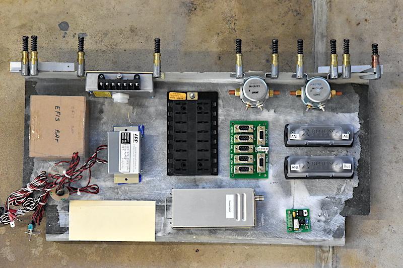

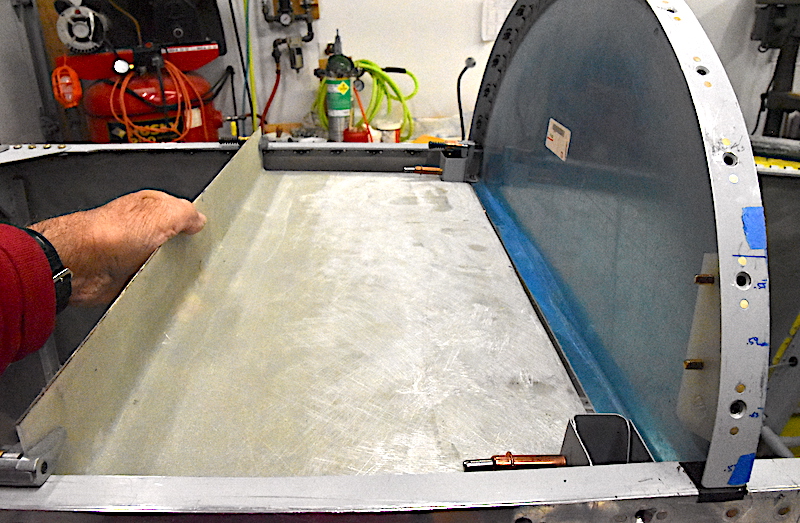

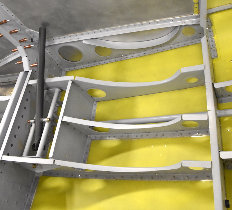

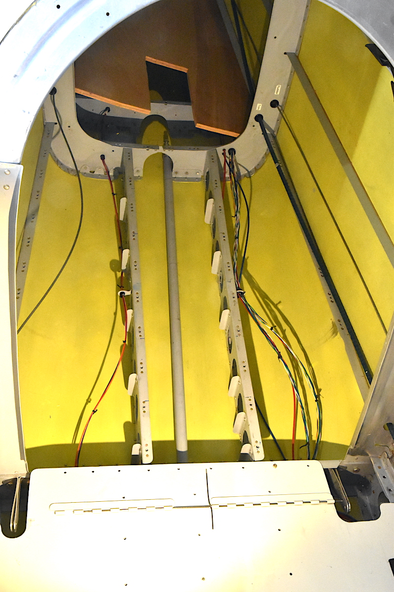

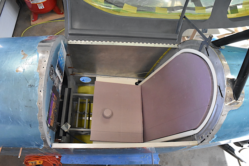

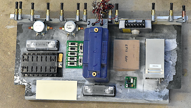

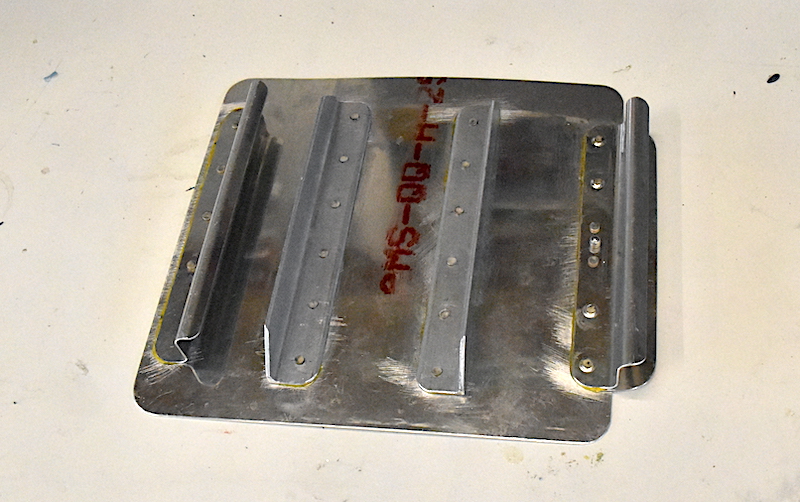

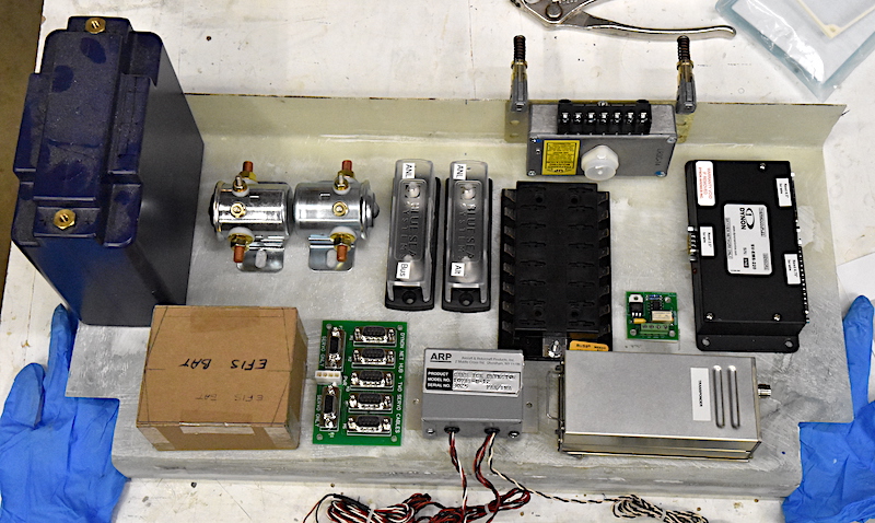

If you don’t remember the avionics shelf, go back to post #473 for a quick review. I removed the forward coaming, the cover forward of the panel, and trial-fit the avionics shelf to the fuselage. Here it is roughly in place.
Its aft face will become the switch panel. Here’s a view from the cockpit showing that face.
The shelf had been resting in a pile of parts. Being fiberglass, and this being a fiberglass phase of the project, it seemed appropriate to do a bit of work on it.
Dave
Here’s the avionics shelf with the goodies resting on it. I think there’s room to run the wiring around but that’ll have to await actual placement.

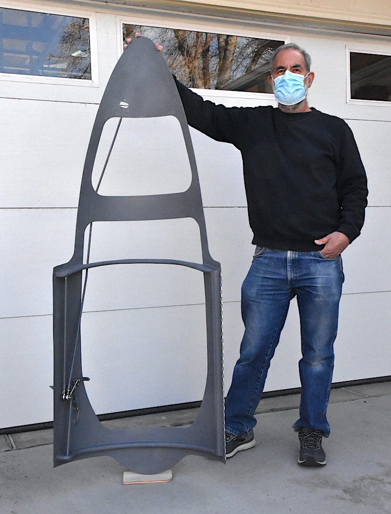

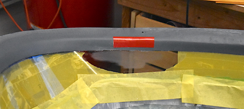

Since then I’ve been filling and sanding the canopy frame/fairing assembly. You know (or will know) the routine:
Fill, sand, paint, repeat. Over and over again.

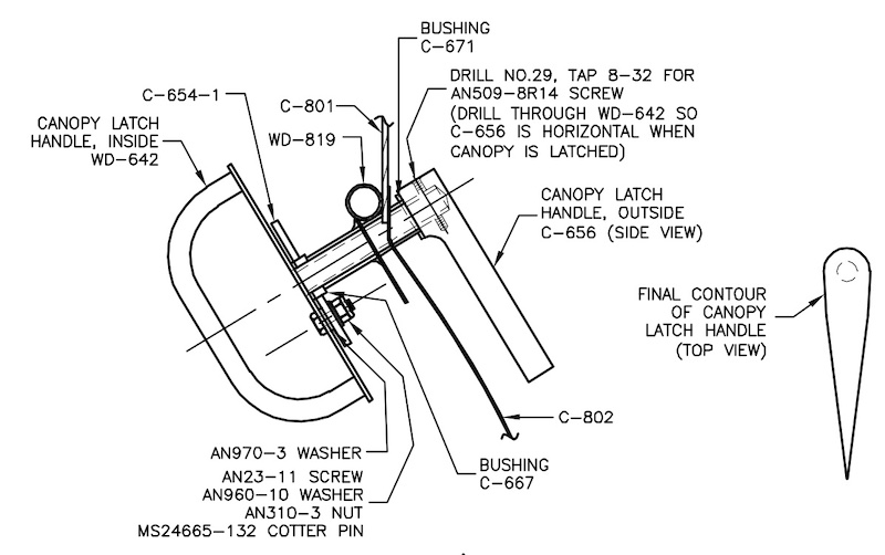

In this sequence, there was a lot of time where I’d be waiting for something to dry. One thing that needed doing eventually is the manual flap handle latch system. Most of its interior parts are complete but unassembled; the latch or quadrant attachment has not been started. Here’s an overview of the system from drawing 30.

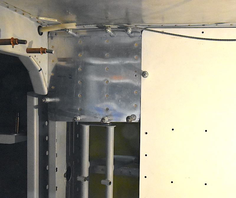

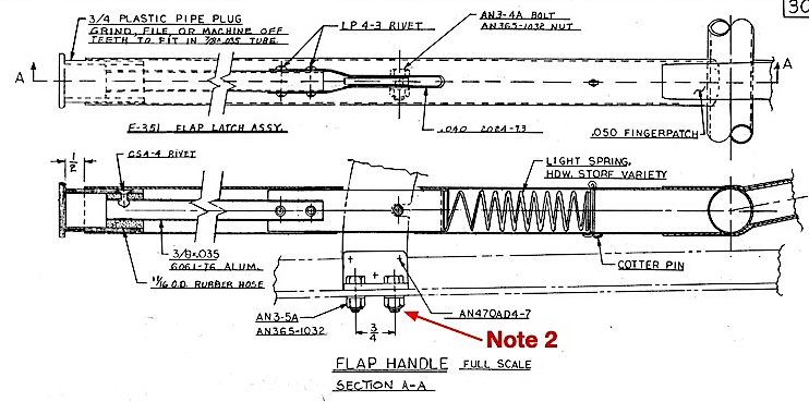

Note 2: See these AN3 bolts? That’s because the latch hangs off of the seat rail, and the downward force is carried in what stress analysts call “heel and toe action,” with the bolt in tension. The quadrant must rest solidly on the seat pan - this was verified. It’s not a robust design and in any event, it interferes with my flat seat, which has #8 screws all along that angle.

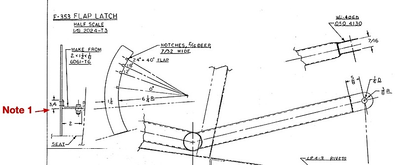

Here’s what it looks like looking aft, also from drawing 30.
Note 1: With a downward force on the quadrant, those poor bolts need to transfer all the bending into the angle. The drawing shows the quadrant resting on the seat pan. Remember that my seat pan rests flat on that angle. I was pretty sure that I couldn’t get #10 nutplates in there if I wanted to. So I installed one more #8 nut plane and looked for ways to eliminate the bending around the rail.
After rejecting things like struts underneath, I settled on a beam to the seat rib next inboard. But since I’d need to cut away the seat pan to clear the mounting angle for the quadrant, that 2 x 1 1/2 x 1/8 angle, I needed to support the free edges of the seat around the hole. This shows the beam in place.
