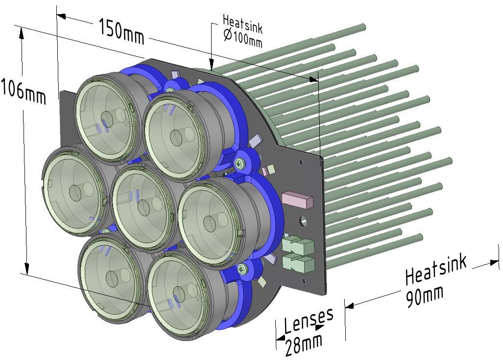

Note that I have changed the shape of the Seven Stars light slightly since that first post was made, and the lights are now much easier to fit into a regular light bay.

Yes they will be the new shape. I took the top and bottom edges off the circuit board so it now (in most cases) fits through the leading edge opening.
Paul. I bought the seven stars and am about to install in a new build using an RV 10 kit I got from Vans. The light and heat sinks fits perfectly into the mounting plate. However it seems that the board is just a tad too wide to be able to secure it to the mount horizontally. Is it ok to turn the light 90 degrees and secure it at the top and bottom instead of in the side? The mounting plate is slightly higher than the width. Not sure if it matters for how the beam may be aimed.
Hi Tommy
No issues with mounting the Seven Stars lights at any clock angle. The diffuser lens for taxiing has a circular beam pattern, so it works the same in all orientations.

As just mentioned above by Tommy, for the RV-10, the Seven Star Led lights need to be clocked 90 degrees and new nutplates installed. the below picture was taken before the new nutplates were added to the brackets.

The hole in the leading edge is much larger in the Van's kit, allowing for the light to spread wider off-axis.
The light bracket for the Van's kit is riveted to the top and bottom wing skins, as per Dustyone's picture above. The Duckworks bracket attaches between two wing ribs inside the wing instead.
The Seven Stars lights will (usually!) fit into either kit type without issue.
