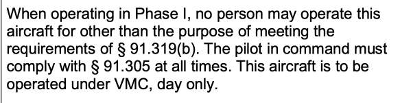

As Brian pointed out in his post # 11, the operating limitations specifically state that the only allowed purpose of Phase 1 flight is to meet the requirements of FAR 91.319. If no other purpose is allowed, then officially designating the flight as meeting the requirements of a flight review, is not allowed.
The standard operating limitations have not changed from the previous with respect to the allowed purpose language. It's curious that the FAR references are specific to 91.319(b) and not 91.319 in general as proposed in this thread or imagined by AI.
91.319(b) is what obligates an operator to stay in the assigned area *until* establishing the aircraft is controllable through speeds and maneuvers, and clearing any hazardous operating characteristics or design features.
  • (b) No person may operate an aircraft that has an experimental certificate outside of an area assigned by the Administrator until it is shown that—
    (1) The aircraft is controllable throughout its normal range of speeds and throughout all the maneuvers to be executed; and
    (2) The aircraft has no hazardous operating characteristics or design features.
There are items described in the PAP test cards that would not satisfy those two requirements and would also be illegal based on the strict interpretation.
This isn't meant to make a strong case that transition training is not addressed (or even appropriate). Based on what we all understand about the importance of Op Lims and how they are written it seems weird that they refer specifically to part (b); leading to the interpretation that anything unrelated to controllability and hazardous characteristics is thus illegal.

Since 91.319 (b) states that flight operations must remain in the test area until sub part one and two are met, and the relevant operating limitation is stating that flights can be made for the soul purpose of meeting the requirements in 91.319(b), I don’t see how there is a valid argument for completing other purposes during a test flight. I don’t think any of us need a law degree to make a determination that receiving a sign off for a flight review as a result of making a phase one test flight, is an entirely different and unrelated purpose.
Right, I understand that interpretation. The problem with the Op Lims and FARs as presented, is that PAP items like flying a speed box or the timed climb is illegal. Just like a flight review, those are also entirely different and unrelated to controllability or hazards. We can't just pretend that the specific items in (b) 1 & 2 don't exist, or mean a nebulous bundle of favored but unlisted purposes.
An interpretation that does work is that is that you are not limited to the allowed purposes and test area while in phase 1, if you have flown enough of a test program to establish controllability and cleared hazards. You don't need a law degree to see that's what the words in 91.319(b) 1 & 2 say.
This could be worded better whatever the true intent. @Brantel , sorry to muck up your thread with geeky reg's stuff. It happens sometimes. :)
I am totally baffled regarding how you made that determination…🤷🏼‍♂️
How can confirming performance values published in the POH, and verifying that instrumentation indications are correct and remain within normal parameters, not be associated with confirming there are no hazardous operating characteristics or design features?
You're measuring the text with a ruler and a rubber band at the same time. Establishing performance numbers and calibrating instruments is not the same thing as verifying controllability and identifying hazards.
You're the DAR. I can accept that your word is the one to rely if the text of the op lims and regs aren't important and there is discretion to include "associated" activities. It's totally reasonable to do calibration and performance, and it's conventional wisdom. It's just not what the words say and this is the first time I've seen the rubber band approach applied to reading op limits by someone credible.
It only works to say it is not what the words say, if you apply your own self determine definitions to those words.
Repeating myself, I am totally baffled why you are posing an argument that goes directly against pretty much universal policy within the FAA for many many decades… regardless what we think the minutiae levels of definition are for a few words.
If your argument were valid, it would make a large percentage of all of the phase 1 flight testing flights that have been made in the past by Home builders, entirely illegal.
That is nothing short of silliness
That’s all from me
