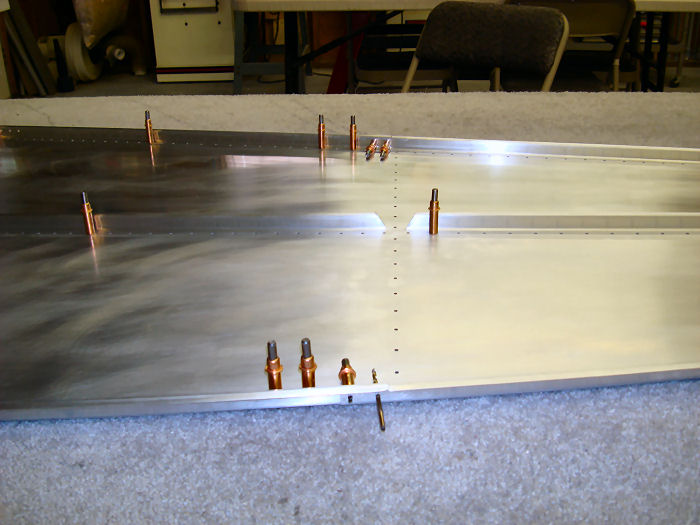

I started to assemble the tailcone. Page 10-06 Step 4.
Unfortunately the J-Stiffeners F-1283A & B do not fit at all. It is almost one hole diameter off.:confused:
Does anybody have an idea what could be wrong?
Wolfgang
Could you post an image of that part please?
I remember that every time something hasn't fit or seemed ackward, it was always me who overlooked or misaligned a part.
I would be suprised if in your case the J-stiffeners of the skins don't fit in.
Go back and retrace all steps leading up to that step. It's conceivable a part could be wrong, but highly unlikely.
Image of J-Stiffener

Alignment
I am not in my shop right now so I can't answer 100%,
but to me it looks that the F-1283A stiffener should be placed outside of the J-channel of the skin.
In your picture it is located inside the J-channel.
The F-1283A stiffener has to be placed inside of the J-channel of the Skin.
In the meantime I received some information from Vans. They are back from Oshkosh now.
This Problem is caused by a mis bent part and happened a few times recently.
It will be a quick and easy Job to fix.
I recall marking several sections that did not appear to line up and I was concerned. Once everything was cleco'd up it all lined up.
I do have some ripples over the stiffeners - common as I understand it. Vans said build it and fly it... so I will.
