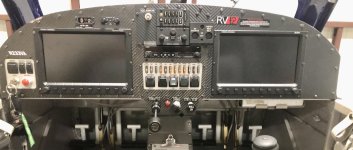

My legacy RV-12 is equipped with the standard Garmin SL40 radio in the center panel. I have dreams of someday having a better avionics, maybe even an IFR certified navigator.
When you look at the center console it looks like there should be plenty of space but when you look harder, especially behind the panel, it is clear there is really only space for that dinky SL40.
I have thought about reworking the fuse and switch panel. Internal VP-X electronic circuit breakers and switches moved to under the panel would free up a lot of space. The Dynon panels aren't huge but maybe they could be moved somewhere else.
What have others done to get more center panel space for avionics?

I build my RV12 with the VPX system. I really like the functionally and I went with Rock Rack switches attached to the VPX. The panel was cut by UpNorth Aviation, he has the Cad Drawing with dimensions and can cut what works best for you.

You can stuff a certified IFR Navigator in the panel, I have an IFD540 shoehorned in with almost zero clearance to the firewall. Looks like you would have to move the Transponder and ADS-B in addition to the other Dynon panels. You could go with a Garmin GNC355 and remove the existing radio to combine the GPS/COMMs or add a GPS175/IFD440 above it.
Also, watch the power budget as you already have dual SV-D1000s and may want to add a heated pitot if you really want to fly in IFR conditions. Plan on another GPS antenna and a VOR/ILS antenna.

Here is an option I measured carefully. I also spoke with Stein and worked out the wiring to include the GPS 175,
