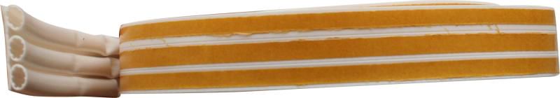

You need to seal the space. I initially used stiff foam and it sealed very well on the ground. During flight the canopy lifts a little and I had a lot of draft.
I now use a black hollow silicon based profile from Elton (Dutch company). Two strips (from the three like the picture) is exactly the width of the canopy frame. It covers from 1-7 mm / 0,08-0,28". Seals very well and looks good.
