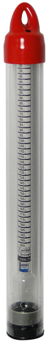

Anyone have a tank stick for their 10 and can take a pic with a scale next to it ?

BTW I thought interesting the number of negative comments on ACS for their Fuel Stik For RVAircraft that you can't get a reading when the tank is less than 1/3-1/2 full. I guess they don't understand the effect of dihedral. :rolleyes:

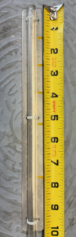

Sorry for the delay. Hope this helps

Thanks, so starting at the top 0 inches represents the bottom readable fuel amount and looking at the dihedral I come up with there would still be ~7.5 gals in the 30-gal tank? Each yellow mark represents X gals? It would seem to make sense to have this a whole integer, but 4 gals seems low and 5 gals seems high. (assuming my 7.5-gal number is correct)

Thanks !
I bought the generic, unmarked stick tube from Spruce. Started with a completely empty tank, filled to 5 gallons, marked the stick (barely readable, very close to the bottom of the stick). Kept adding 5 gals at a time and marking the stick at each interval until I had it marked at 30 gal/full. My tank floats show full at 25 gallons, so my G3X doesn't accurately measure levels until 25 and below.
Sorry, have not had a chance to clean this up but seams to line up to refill amounts.
