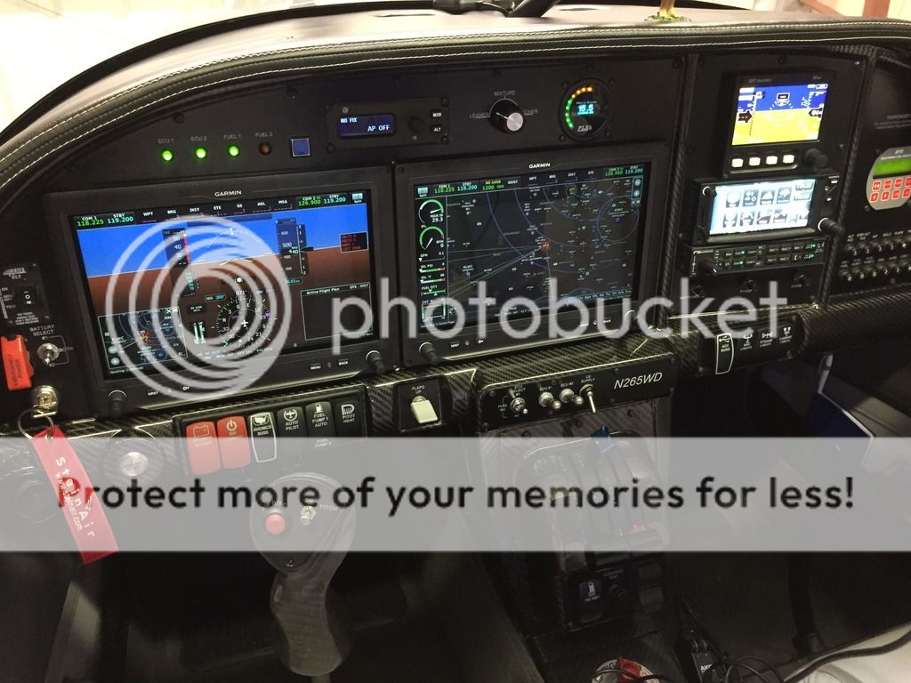

Justin,
Here is a close up picture of the 10" EFIS panel showing you the left side of the center section and how it's canted back. It's roughly a 1" set back on the left side.
Justin,
Jason that's a good looking panel! Nice to see the spacing in a picture. Is that 305 butted up to the left of the frame piece behind the panel? So it's fine to put that on either side?
Also what are those panel screws you used?
G5 on an angle
Thanks Justin. The 305 ended up being centered between the F-1044 and F1045 ribs. I think if you set it centered over the left or right panel you might have an interference issue. Take a look at where the F-1044 rib is (red circle) in the picture.
The screws I used for the panel came from McMaster, part number 91355A075 - Hex Drive Flanged Rounded Head Screw, Black-Oxide Alloy Steel, 8-32 Thread Size, 1/2" Long. The finish on them blends very well with the matte powder coat on the panels. You will have to use 9 flat head screws along the bottom and right side of the panel. This is because the two screens sit over top of these screws and button heads won't allow the panels to be flush. In this case I used screws from Micro Fasteners, part number FCMXS0808 - 8-32 x 1/2 T15 - 100 Degree Flat Head 6 Lobe Drive Machine Screws - Stainless 100 pcs/pkg and just powder coated the heads the same as the panel.
