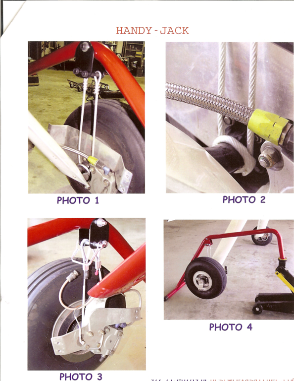

I bought my -10 and the seller had an aluminum dowel that slides into the axel for jacking. It works well and stays in the plane for flats. I was surprised nobody else mentioned this technique.

It works the same way as the item now sold by Aircraft Spruce but originally sold way back in the day by Avery Tools:
Remove the axle nut (the wheel won't come off the axle), insert the shaft into the axle halfway, jack up the wheel with a floor jack, slide the wheel out onto the shaft, put a block under the axle and remove the shaft with the wheel. Reverse for installing the wheel.

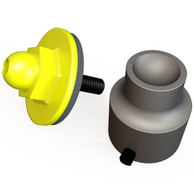

As to jacking options- I just added the flyboy alu jack points at my last condition inspection. I also have the bogart screw in jack point and cup should I need to use a real jack. They seem less likely to come off.

I have one of these in my hangar, never used it. I'd sell it if anyone is interested.
I have the Flyboy jackpoints installed and keep the lift arm doo-dad and a Phillips screwdriver in my plane in case I turn up with flat on the ramp and at remote airport, but I want a solution in my hangar that doesn't involve removing the wheel pants, so wing jacks are my choice. I exchange my tie down on each wing for a polished grade five 3/8 carriage bolt and use the old Harbor Freight pump jacks I built myself following some Kitplanes article I read somewhere. Between the two solutions, that's what works best for me. I suppose slipping off the jack is a possibility.

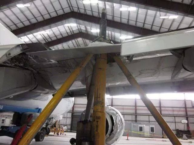

When you swing the gear on a large aircraft/airliner with hyd mules hooked up the whole airplane shakes, it's definitely not for the faint of heart :eek:
If you ever witness the operation, it becomes evident that jumping of the jacks is a real possibility if everything isn't set perfectly.

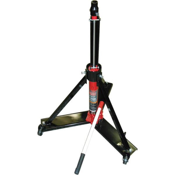

...the old Harbor Freight pump jacks I built myself following some Kitplanes article I read somewhere. Between the two solutions, that's what works best for me. I suppose slipping off the jack is a possibility.
I bought a used set of aircraft jacks and Bogert RV Jack Pads. I also have to get under the wing and lift my RV-7 with my back to slip the jack into position (I realize this thread is discussing the RV-10). Without doing so, the jack is a couple of inches too tall.
I went to Harbor Freight and measured their flat-bottom ram to see if budling my own set would net more clearance, but it seems like it would end up nearly the same height as what I have.
I assume those of you with ram style aircraft jacks have to lift the wing as well?

Harbor Freight no longer sells the 3-ton long-ram jacks that I used to build these wing jack as was detailed in the Kitplanes article. I believe that they are sold by Northern Tool (at twice the price)
https://www.northerntool.com/produc...-hydraulic-jack-single-piston-flat-base-46210
That particular jack fits under the wing of my airplane just fine...no need to do any manual lifting.
