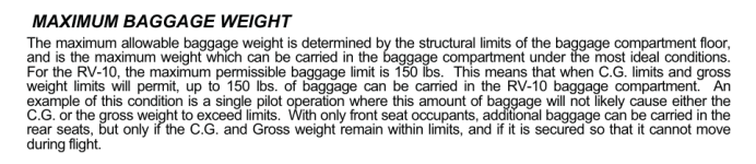

The W&B info that came with my RV-10 (finish kit delivered late 2009) said "Maximum baggage area weight - 150 lbs". I even put a placard back there. But I see Vans is now advertising on their web site a maximum weight of 100 lbs.
Does anyone know why the change? Does this apply retroactively? (no SB that I know of).

Bob, I am pretty sure it has always been spec'ed at 100 lbs.
Is it possible you are mistaken? And if not, can you point me to the document that lists it at 150 lbs?
Baggage weight
"For the Rv-10, the maximum permissible baggage limit is 150lbs."
Located in the Maximum Baggage Weight section on page 2 of Weight and Balance section. W&B Rv-10 .doc dated 2/4/05.

150lbs is correct according to the documents I got from Vans, its the maximum structural strength of the baggage area:
See picture below:

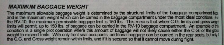

Can you post the dates of the manuals? I, like the posters from 12 years ago, have a manual that states 150lbs in the W & B Section. I'd be curious as to when the change occurred.
Thad said I've never come close to 150lbs in practice--I always cube out before hitting even 100lbs.
2/04/05

I just went to the Vans website to view my plans and it still shows 150lbs there on W&B page 2. I’m not home so I can’t look at the paper plans that were sent with the kit. (2018 empennage purchase)
Look at:
And it will state:
Seems fairly clear what the specification is. (It's on 5 of 22)
