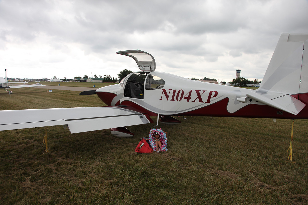

Locations
This is what I did and why:
Coms: I put both coms on the bottom and they are under the rear passengers seats as far apart as I could get them. I have only had one or maybe two airports that had a hard time hearing me on the ground (only one had me taxi to a different location before calling), where the antenna on top would have been better. I think my next RV-10 will have the fiberglass antenna on the top.
Transponder: The transponder has a minimun distance from the coms because of the power it puts out. I also wanted to keep it away from the occupants due its high power/radiation. Therefore, it is located behind the baggage compartment, about where the battery is located.
ADS-B: To keep this one away from everything I put it just in front of the rear tie down. I can reach down, through the lightning holes by the vertical stab to install and maintain it.
VOR/ILS: I have the Bob Archer wing tip antenna. I plan on putting an antenna on top of the vertical stab someday. I have flown with other RV-10's with a more traditional antenna and they have can receive VOR's farther away than I can. The Bob Archer antenna works great knowing that most of the time GPS is used and ILS/VOR approaches work great with Bob Archer.
By making to slits in the vertical stab, the VOR antenna sits perfect up there.
I also have an transponder type antenna for my traffic scope. It is located in front of the COM antennas.
I have three GPS antennas on the top. One if for the Garmin 430, one for the Chelton and the ADS-B is under the vertical stab fairing.
Here are a couple of pictures. The first two do not have the ADS-B antenna.
This one shows the ADS-B antenna.
