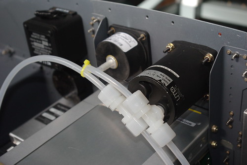

I installed a UMA ASI and Falcon Altimeter, both 2 1/4". Can't recommend either one as I haven't used them yet. They weren't that expensive so they probably aren't great quality either, but should be OK as backups. I used Tee's as shown. Bought an extra static kit from Vans which had all the right pieces. I ran the static line down the right hand side under the passenger seat to avoid the tunnel.

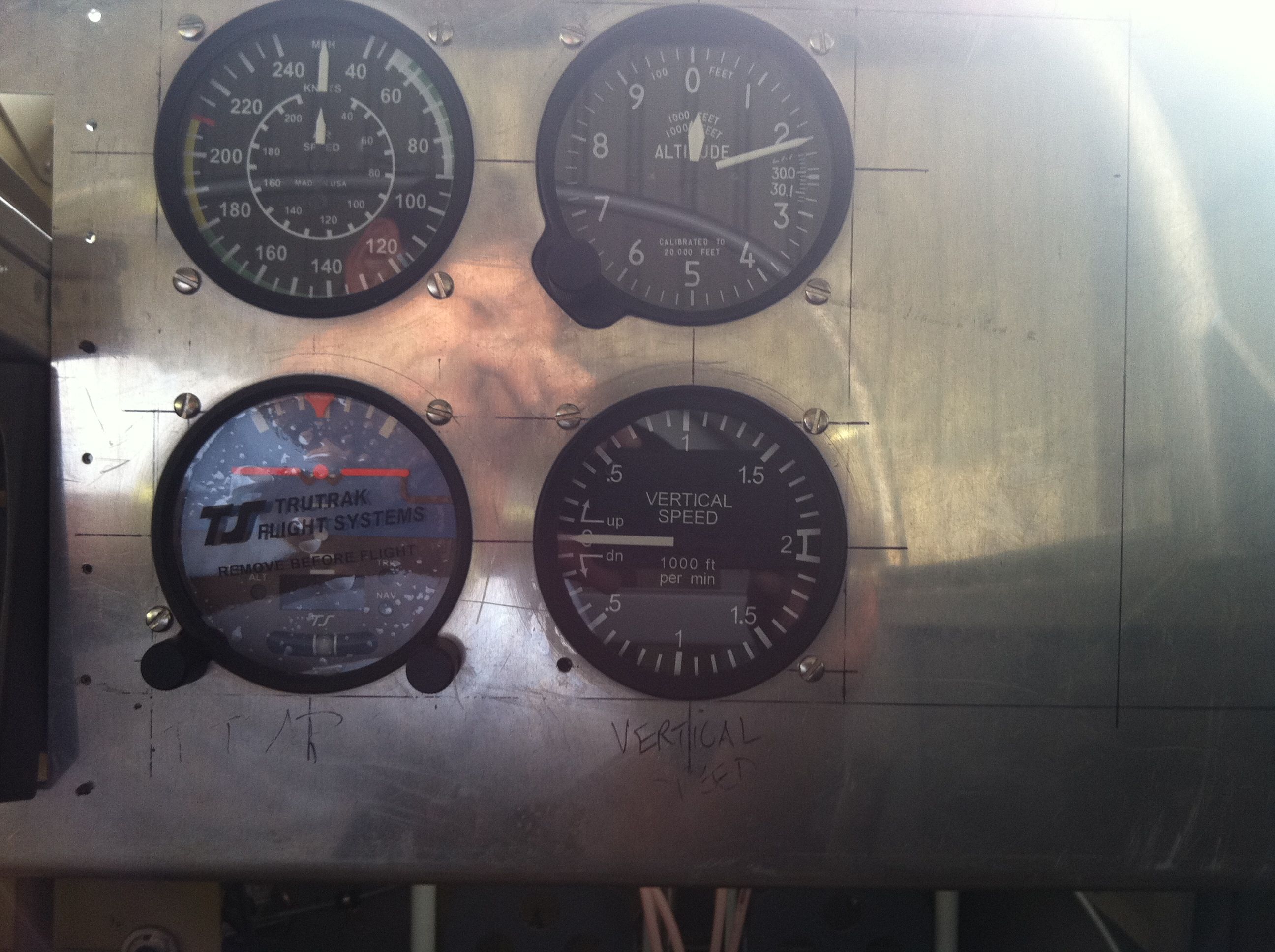

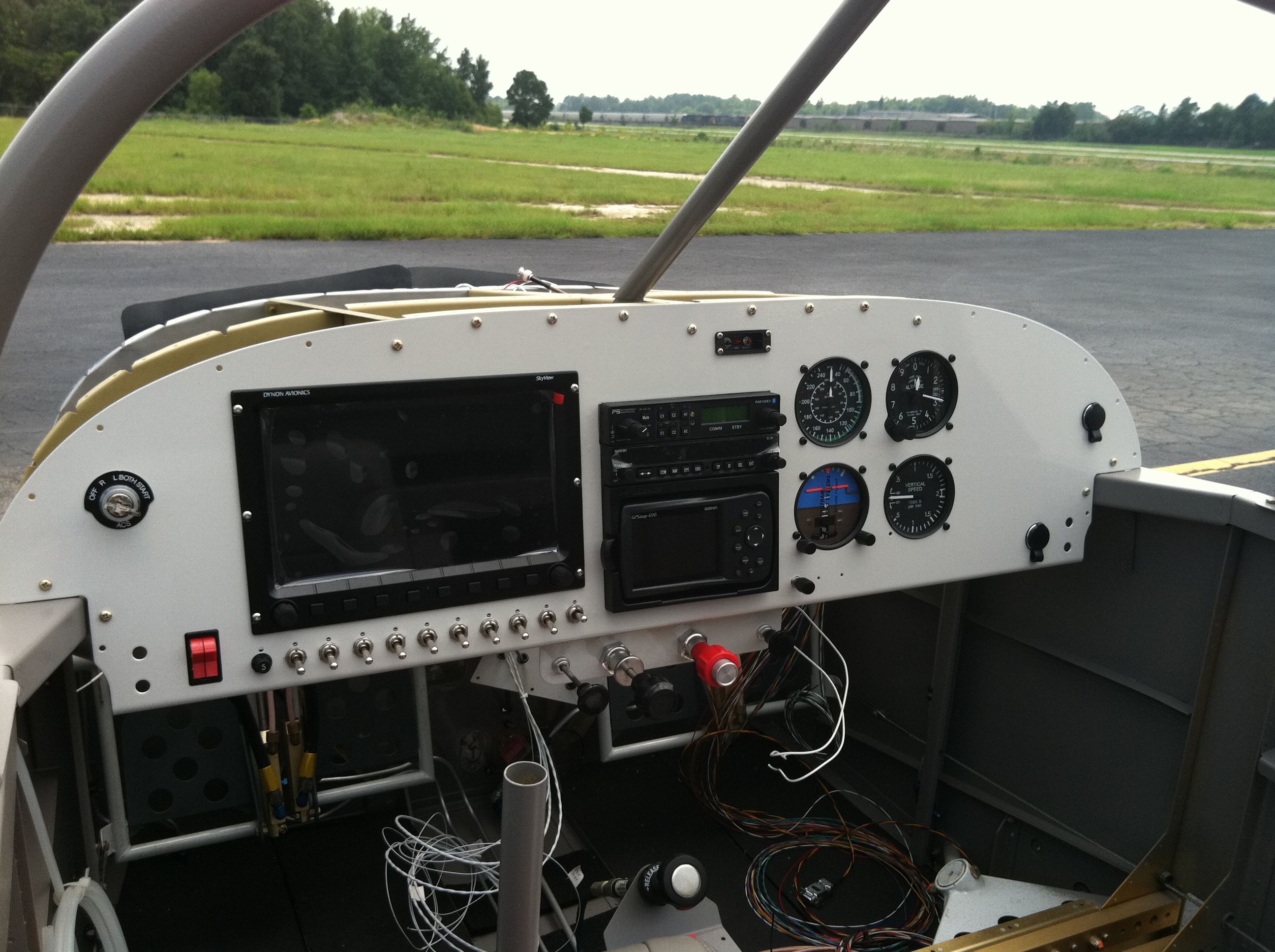

I bought my backup steam gauges from Vans. At the time, they were to accompany a Dynon D-10A. After building for a "few" more years, the Skyview came along and that was my choice. I spent a lot of time trying to figure out how to lay them out on my panel. I had three gauges: ASI, ALT, and Trutrack AP. I didn't think I had enough room to orient them vertically (3.25 gauges). After scratching my head forever, I finally decided that three gauges might be my problem, so I added a fourth: VSI. After I cut my hole for the Skyview, I mirrored the Skyview layout for the four gauges on the other side of the radio stack. If I ever feel the need, I can cut a rectangular hole where the four gauges are and install another Skyview.
http://www.aclog.com/rv-9a/images/Firewall%20Forward/49d256b4070631b6cffac9632e72752610337_IMG_0812.jpg
http://www.aclog.com/rv-9a/images/Firewall%20Forward/e8cdbc4a5c3b1321b08c0514bbf40170794_IMG_0459.jpg

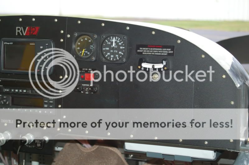

In an RV-12, I don't think I'd bother with a backup ASI or altimeter. Although I've never flown in a -12 yet, I'd bet it is much easier to judge airspeed for landing by power setting, and feel and sound of the aircraft in case the EFIS fails, than one of the fast tailwheel RVs. Being a nosewheel airplane would also be a big help in landing without a functioning airspeed display.
Now in a fast tailwheel RV, I'd definitely want at least a backup airspeed steam gauge. I can judge height and getting to a pattern altitude just fine with the good old "Mark-I" eyeballs, but slowing these planes down, and holding the airspeed to that narrow happy range for a smooth landing just by power settings, and feel and sounds is a bit more difficult.

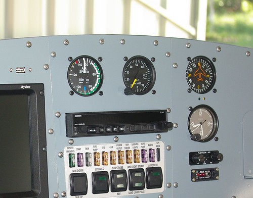

Three small backups ...
...all 2 1/4" ... UMA altimeter, Vans airspeed, and a decent quality but lesser cost whiskey compass whose mfgr I can't recall at the moment. Very little panel space - or cash - required. :D

Being an old school (and old, too) engineer who believes that electronics will fail, probably at the worst time, I installed airspeed, altimeter and a ball as soon as 143WM got her pink ticket. Helps my co-pilot a lot too, since the D-180 is hard to see from over there. There's no need for much extra plumbing; I bought T-fittings and 8 feet of static line from Steinair, replaced the white plastic fittings at the back of the D-180 with ones from Steinair, capped one leg of the T and ran the other to my new gauges. Yes there's a difference between my cheap gauges and the D-180, but I'm not convinced which is wrong.
