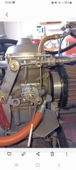

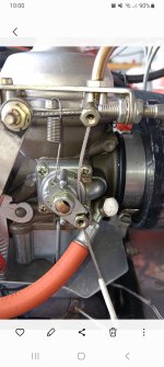

After 2 years of on and off troubleshooting, I inadvertently discovered my problem. While comparing another RV12 to mine, I noticed his choke arms are 180 out from mine. I confirmed in the manual that that his are installed correctly. Flipped mine 180 and all is well with the world. I'm embarrassed that I did not catch this sooner. Dog leg should be pointing down not up. 1st pic is wrong. 2nd pic is correct.

I’m missing something in the translation…. I see your photos and understand that the actuating plate was installed incorrectly, however… it appears that the rotating brass shaft is still in same position when the plate is installed correctly. This doesn’t explain any difference in operation of the enrichment circuit (choke).
Jim,
I don't what to tell you. Here's what I know: I flipped the arms over and I gained 100 rpms at full throttle static as well as an increase in my idle speed. I had to redo my mechanical rigging and rebalance the carbs pnuematically. As previously stated, it runs very smooth now.
The brass shaft is in the same position in both pictures. But it might not stay in that position when the engine
is running because the spring has little tension in the first picture and greater tension in the second picture.
It may appear to be but it is not in precisely the same position.
The plates are not symmetrical in shape so when reversed and the plate is in contact with the stop, the shaft is at a slightly different position of rotation.
