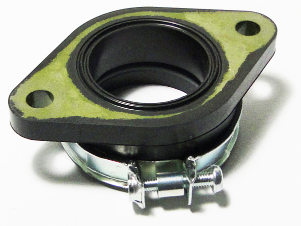

If the carb mount is removed from the manifold so that it can be inspected, a raised area around the flow path hole can be seen. It is basically a molded in O-ring that will seal on the aft side of the drip tray (if installed).
There is an o-ring in a groove on the intake manifold that seals the fwd side of the drip tray.
If no drip tray gets installed, the manifold o-ring compresses on the flange of the carb. mount producing a double seal.
In the case were the o-ring was incorrectly installed, the builder moved the o-ring from the grove in the manifold and attempted to put it in the very small grove that surrounds the integral seal of the carb. flange. It does not fit... so it squirted out during installation.
