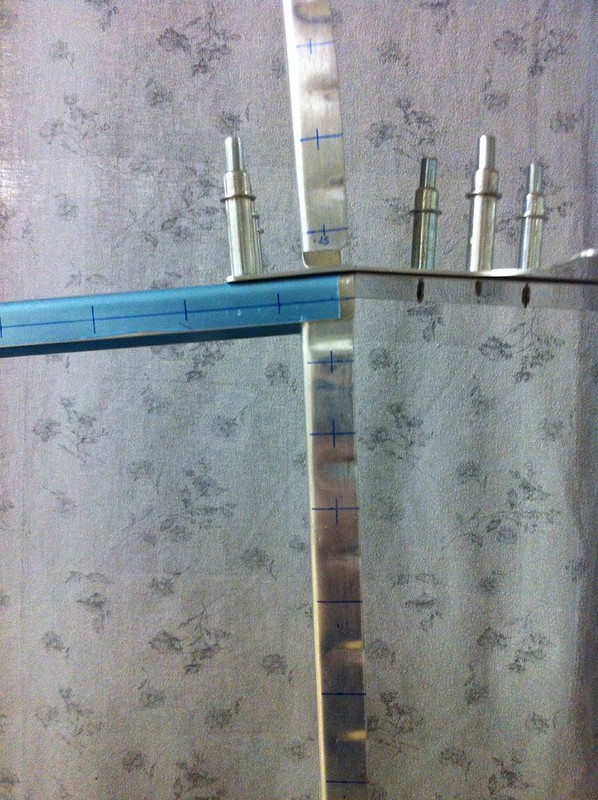

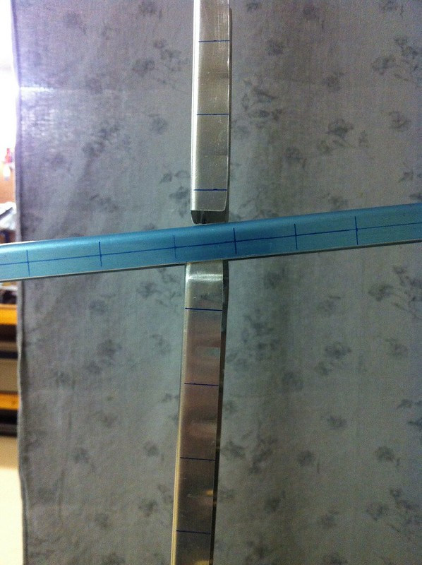

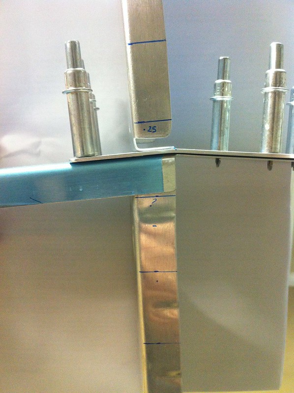

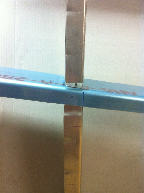

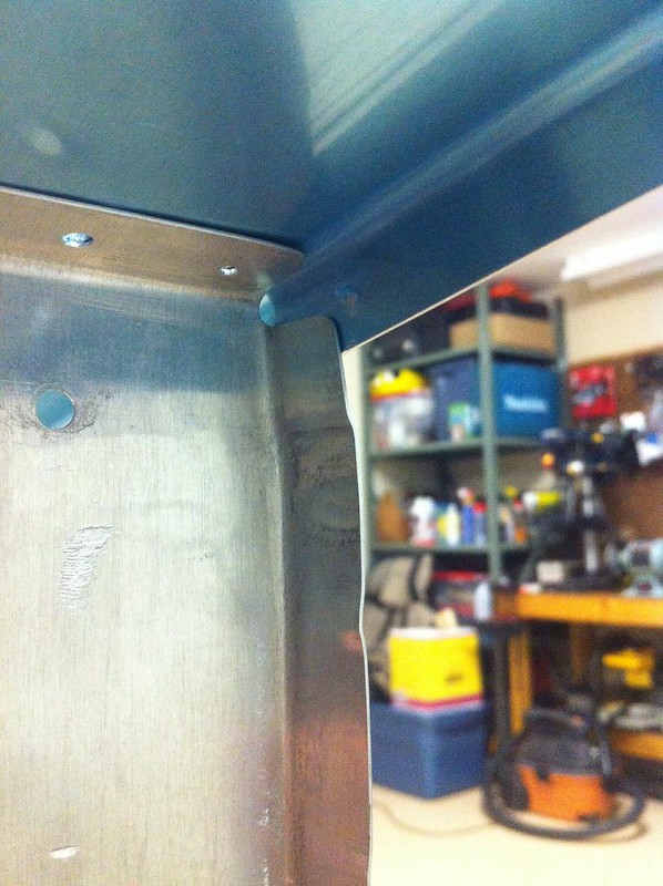

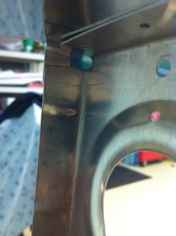

I need some advice on planning out the rivet spacing on the Horizontal stab ribs, specifically where the mid and root ribs intersect with the forward spar channel. Both of these ribs have a joggle on the flange to allow it to fit inside the channel of the forward spar. In order to plan out my fluting locations I needed to lay out the rivet locations. Drawing 3a indicates 1.25" nominal spacing (can be closer but never further apart) but this places a rivet directly in this intersection area. It doesn't look like I can skip over this area without breaking the 1.25" rule and to put a rivet here will barely catch the area of the rib flange inside the spar channel and certainly not meet minimum edge distance of .25"

Should I simply remove more of the flange so that the rivet will only pass thru the skin and the spar channel?
Should I not put a rivet here at all and rely on the rivet line along the forward spar (skin attachment)?

If you don't have ED for the rivet hole, do not put a rivet there.

Adjust your spacing to insure you have the edge distances where you can along the main flange. Rivet spacing is really a maximum. A rivet fan somes in handy, but if you need to adjust one to 1" or something on the end of a line, it doesn't look bad.
In regard to the flange overlap where the joggle is, this is classic RV3,4,6 problem and really no fix short of rebuilding the entire flange or scabbing in a repair.
If you look at the pictures in the SB thread, you will see some very good examples of how most have handled this.....they put a rivet in there as best they could to average the edge distance on both parts, probably not meeting the minimum on either one.

If you have a rivet fan spacer just use it to get a good even spacing as long as you don't exceed 1.25" or less than 3 times the rivet diameter. That's how I would do it.
Thanks fellas. On the mid rib location I am able to alter the spacing a bit but with the root rib I can't move them any closer together without getting into the joggle area and would definitely not maintain proper ED on the flangle/joggle area. Really not sure what to do here. I can leave that one rivet out and try to space the line that runs along the flange of the spar channel in such a way that the nearest rivet might be around 1.25" away but off to one side of the intersection area.

As for the rivet spacing conundrum, think 'tractor' and not 'space shuttle'. I repeat again: do not put a rivet where it will not have proper ED.

As for the OP. Make sure you maintain edge hole distance on the spar. If the rib ends up being right on the edge then just cut it off so it won't develop a crack. I had the same question for Vans and that's what the engineer told me.
Not exactly sure what you mean Sid. Do you mean that if a rib flange ends up being on the edge of a rivet hole to cut off the flange to clear the rivet?
