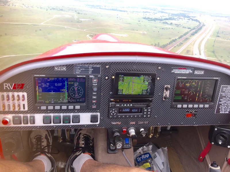

I recently completed a panel upgrade in my RV-8 which included replacing my 496 with a Aera 660. The rest of the panel is dual G5s, GNX375 plus GMC507 autopilot system. The original 496 was mounted to the panel in a Gizmo mount with hard wire connections and was quiet as a mouse, no interference noise at all. Not so with the Aera 660, it's noisy! It's also mounted to the panel using the bare wire connections; it took a few minutes of detective work to narrow it down to the 660, but once I figured that out, then to determine, what's the source? Power, audio or RS232 data?
I'm using both of the 660's 232 data ports to the G5s and the 375; I switched off the ports but the noise remained. Yesterday while in the hangar I disconnected the 660 audio feed to the audio panel... aha! Silence! I was happy up until I started the engine and the noise was back, although a lesser amount. Well, cr@p! So it's not the 232 data (or is it?) and the audio is disconnected, so what's left? Power. The noise does rise/fall with RPM, so, alternator power noise I guess? And how the heck do I fix it? The bare wire connector was cut fairly short in my install since the -8 has a compact panel; there is shielding in the connector but I only used about 6" of that wire before opening it up to tie into the the 232 and power leads. So, anyone else run into this and how to fix it?

Hey John,
So when you are sitting in the hangar, you hear the audio interference, and upon removing the audio line from the 660, the noise disappears completely, until you start the engine, when the same noise shows back up?
When you disconnected the audio line, did you remove the wiring completely? What audio panel are you using?

Thanks Justin,
Yep, in the hangar, electrics powered up and headset on, there was lots of static type noise, snap-crackle-pop. I then pulled the 660 audio (Left channel) wire from the audio panel and all went blissfully quiet... but upon starting the engine, the noise was back. It wasn't quite as bad as before, but still annoying. Powering up for taxi/takeoff, the noise amped up a bit.
I don't have a true audio panel, but an AP-60 Audio Mixer linked below; it's a mono unit, so I just have the 660 audio Left channel to the AP-60, R is unused, Common is grounded at the AP-60. I didn't remove all the audio wiring, just pulled the L channel wire and capped it.

John. Have you tried attaching the bare wire cable shielding to its own ground wire? That's what Garmin does internally in their cables at the bare wire end. But if you cut the length of the Garmin cable down the connection of the shield to the ground wire is lost. So solder a jumper wire to the shielding and then connect it to the ground wire. If you already tried this and it still gives noise try connecting the shield to the DSub connector backshell on the audio mixer. If your backshell doesn't have a convenient location for this then put a ring terminal on the shield jumper wire the same size as the retaining screws on the Dsub connector and sandwich it between the connector and audio mixer using one of the thumbscrews as you attach the connector. If you disassemble the backshell you can also put the ring terminal on the top of the same mounting screw which is a better long-term solution since it stays together without confusing the next guy.
Also, if you have been trying different connections to the shielding already and haven't tried it without the shield "open" meaning not connected to anything then by all means try that too. I had that happen one time in an airplane on a LEMO plug installation. Nothing worked well until I clipped the shield drain wire. Go figure.

Try installing a ground loop isolator between the GPS and your audio panel.
Van's supplied one with the original D180 kit.
Search Van's Aircraft store for "AV GROUND LOOP ISO"
Or perhaps eBay item number:151617844291 or Amazon

Which input on the AP-60 are you using?
If the common is still grounded at the AP-60, remove that line and see if anything changes, to try to narrow things down a bit.
What are the alert and message volumes set to on the Aera 660? If they are set low, and the alert input gain on the AP-60 is set high, that could exacerbate any audio interference issues. Ideally you want the 660 volume set fairly high, with the audio panel alert input volume set lower.

...If your backshell doesn't have a convenient location for this then put a ring terminal on the shield jumper wire the same size as the retaining screws on the Dsub connector and sandwich it between the connector and audio mixer using one of the thumbscrews as you attach the connector. If you disassemble the backshell you can also put the ring terminal on the top of the same mounting screw which is a better long-term solution since it stays together without confusing the next guy.
