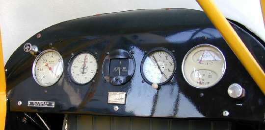

CFR 91.205. That is not correct. Ever see a Piper Cub J3 instrument panel. That is day VFR. Compass was #1 Nav instruments (and your eyeballs, map, watch) from the most early days of flying before GPS was even glimmer in anyone's eyes. Even A-N "Radio Range", ADF, VOR, LOC don't work unless you know our heading.
(b) Visual-flight rules (day). For VFR flight during the day, the following instruments and equipment are required:
(1) Airspeed indicator.
(2) Altimeter.
(3) Magnetic direction indicator.
(4) Tachometer for each engine.
(5) Oil pressure gauge for each engine using pressure system.
(6) Temperature gauge for each liquid-cooled engine.
(7) Oil temperature gauge for each air-cooled engine.
(8) Manifold pressure gauge for each altitude engine.
Another 9 items not related to instrument panel for day VFR. For night VFR there are another 6 items.

Great Grandfather of Day VFR.. A simpler time. Before my day but I still make students fly by dead reckoning and pilotage, in part it's fun, and FAA still requires it.
