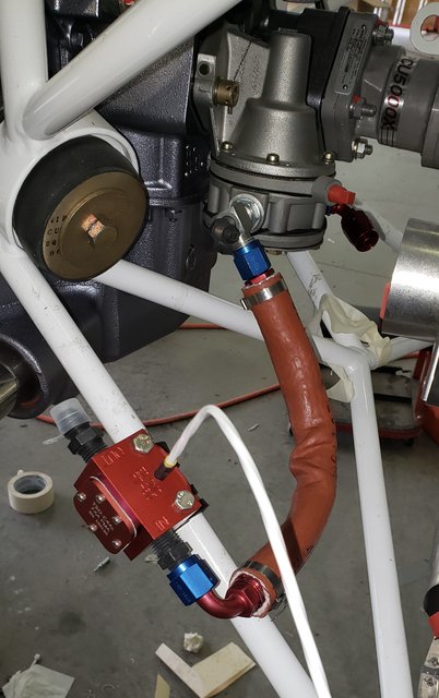

Mine is suspended by the fuel line in between the mechanical fuel pump and the fuel servo and covered by a length of firesleeve that Aircraft Spruce sells for this purpose. IOW it’s not rigidly mounted to anything.

On my first RV-10 build I mounted the sender per plans. If the boost pump was off it gave an accurate reading. Turing the boost pump on the reading jumped up. I also note that on rare occasion during a hard climb fuel pressure would drop below normal (boost pump off). I attribute this to the cube location.
The attached photo shows how I mounted it on the RV-8 project. It meets all the fuel sender install instruction requirements and I can report it is rock solid in use. I will do something similar on the new RV-10 project. I know the steel fittings should be aluminum but this is the only photo I have.

I like the idea of mounting to the engine mount with two adel clamps. Would just need to determine the exact location and hose lengths for that install.
While there are many RV10s flying just fine with the transducer in the tunnel, alot of you requested that we come up with a FWF location. WE settled on this location, mainly due to the offset rotation of the flow divider, and the ease of install.
Pictured below is the protoytpe location as tested by our beta testers. Yes, we changed the fittings to steel, and the supply hose was shortened to eliminate contact with the firewall. Current version ships in our FWF RV10 hose package with the integral firesleeved hoses.

I started with my red cube in the tunnel per the RV-10 plans. In that location, operating the boost pump caused erratic and erroneously high fuel flow indications. I moved my cube to a location suspended in the fuel line between the fuel servo and spider, not attached to any structure, covered by firesleeve. It's been about 1000 hours since I moved it. I like the new location. Solid fuel flow indications.

My IO 0360 RV 4 made it difficult to install the red cube AFTER the mechanical pump without hoses I considered undesirable (excessive). I mounted it with adels on the mount behind #3 with a short hose to the spider on top of the case parting line. This encountered two issues you may find useful.
1- to secure the cube and hoses with minimum motion, vibration , i used a small piece of rubber baffle sheet between the adels and the red cube. Very secure with no shaking hoses and good vibration isolation.
2- the cube needed to be mounted vertical for ideal hose length, no 90* elbows and bubbles into the bottom and out the top. The wire needed to exit horizontal, not vertical. RED CUBE advised no problem with performance. There might be a slight variance in bearing life on the impellar.

Mine is mounted between fuel servo and flow divider, suspended in the fuel line and not secured to structure. I have it heat shielded. Flying for 6 yr and no problems.

Like Tim, I've run a cube both before and after the engine-driven pump. When between pumps, the fuel used indication was accurate in cruise with the aux pump OFF. However, it read high with the aux pump ON, and the GPH indication (on a GRT EIS) was never really stable, pump on or off. Relocating to a position after the fuel servo settled all issues.
Any restriction contributes to vapor formation when lowering pressure on the downstream side with a pump. Placing the cube after all pumps makes the restricted flow area irrelevant.
Placement above the servo or up near the divider significantly reduces radiated energy from the exhaust tubes.
Any reduction in hose length reduces fuel heating. Keep 'em short. 45 degree fittings don't seem to bother the cube at all.
