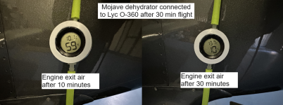

Using an inline hygrometer, I monitor the engine output air from the oil fill tube to confirm the performance of the dehydrator. Here is what I was showing the other day after a breakfast run to KRNP and back. Note that these inexpensive hygrometers only go down to a measurement of 10% but are fine for use as a relative change.Mojave dehydrator results.png
John: I'm very happy with the Mojave dehydrator.
My Thunderbolt is still in the Lyco box -life keeps getting in the way!- so the dehydrator helps reduce the risk of my extended build.
I recently installed the unit in an engine with ASA Oil Separator and Crankcase vacuum kit. Cut the breather pipe and inserted a T-joint with a pipe that will serve as dry air inlet from the dehydrator.
Will observe how the installation works, I've kept it on a 1hr ON , 2hrs OFF schedule and the humidity stays at or below 10%.
