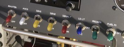

Redid and resprayed my panel Dec 2019, lettering applied free handed as the panel is riveted as per plans...
Used my text program to fill out an A4 size page of needed captions and spare letters & numbers. Choose the font Comic as pleasing and not too critical in terms of alignement...
The lettering of the whole panel took about 3 hours, and most find the result quite pleasing.
No clear coat applied.
Durability has been excellent. As the vendor stated, the longer the dry transfer has been applied, the better it sticks. Still, care has to be taken, as making contact with any sharp object will scratch away said letter or number.
On the other hand it offers great flexibility. I changed some lettering last week and was happily surprised at the adhesion, used my nail and alcohol to rub them off, and applied the new stuff.
Easy to apply, good looking, cheap, and highly flexible.

The vendor in my previous post does white. In fact, you can combine colors, etc. for more $. This technique is used a lot for graphics on marketing models, etc.
The durability is very good, as you are really rubbing down a form of paint. In fact, the nail polish industry recently caught on to this and are selling sheets of pre-printed rub-down nail polish in all sorts of crazy designs. Wife loves it. (Color Street if you want to earn some points)
These do have a shelf life (because of the "paint"). The sheet lettering will get brittle after a year or so. (I don't know exactly how long, but use them fresh)
One of the advantages I found to using the DecalPro system was that you don't have to plan everything out for sure the way everything is going to be all at once and send off to a vendor.
You can make up some sheets with nested graphics and apply them. Then if you mess one up, or you change your mind, or think of something else that you left out, no big deal, you go make some more.
I didn't put any clear over them. For the most part, they have held up very well. After almost 12 years, the labels for the Master and the Boost Pump, are showing some wear. I made 100LL fuel labels for the wing fuel ports, and one of them was damaged when I spilled fuel over it, then wiped it. Oops. If you get fuel on it, just leave it alone.

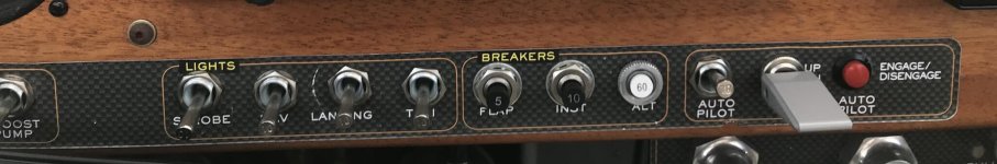

Has anyone experimented with back lighting a laser engraved panel.
Something like this. I've seen sim cockpit guys do it but I'm wondering if their techniques would hold up in a real aircraft.
Yup, a few of us have. You need to have your switches and lights on subpanels that are mounted behind the main panel. This is so you can "sandwich" the mount plate, then an electroluminescent (EL) backlight panel, then some transparent blue film from eBay, then the label. I did mine with EL light panels from ellumiglow.com, and my labels were engraved by engravers.net. Construction photos circa 2015-2017 attached.

Boeing, MD, Lockheed, Airbus, all use this kind of panel lighting. In the old days (DC8, 727), we had a whole lot of little incandescent peanut bulbs screwed in with a little metal caps and the light traveled through the clear plexiglass panel that was painted black usually, with labels etched through the paint. The bulb went in to the receptacle bulb end first, and the metal cap provided the ground. I got pretty good at changing all the burned out ones on a long night flight. I’m sure the newer ones are some sort of LED lighting or electroluminescent sheet system like Scott has. That type of backlighting with engraved labels really looks good at night.
I did it as well. Adds some time and complexity but the cool factor and function is very much worth it.
