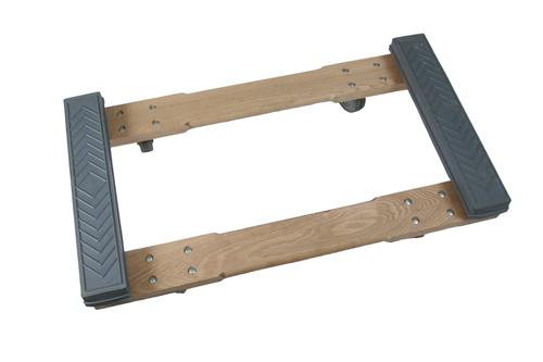

Hopefully my QB fuselage will be showing up in the coming months and I wanted to know what I should have ready when receiving it from Tony Partain shipping? I assume I'll need a cradle of some sort? Anyone have any pictures of receiving theirs and the process of transferring it from the trailer to the shop?
Lynn
Two people can lift it fairly easily.
A furniture dolly is helpful to get it around by yourself.

Fuse will be the firewall back to just aft of the baggage door, so it is not as long as you think. Many different ways to cradle it, search the forum. Initially, I built a rolling dolly that supported the fuse at the spar stubs and rested on the aft of the fuse. I now have a 2'x4' easy lift (thanks Craigslist) that is on casters, supporting the fuse from the entire belly. Hydraulic up/down is really nice!
As the belly is reasonably flat, you can actually set it on the ground until you get the dolly built. Three or four guys can easily lift the QB fuse.

Thanks for the input, sounds like a furniture dolly to start will be the easiest, then I can figure out what I need to do for the future. I already have the wings in cradles, so that's not a concern, just a steep driveway for getting the fuse in the garage.

I had some garden wheels from an auction and with a solid piece of round stock i had handy i made an axle wide enough to cross the fuse, i put that on a carpet covered 2x4 and presto i could move it one person wherever.
