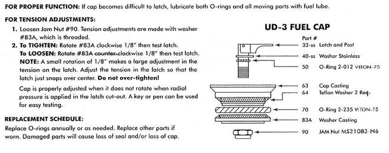

My RV is a late 2008 QB kit and I assume it has stock fuel caps. I want to rebuild them so that I don't have to worry about the pin breaking so I ordered a rebuild kit from Vans. I looked on line for the instructions and noted that the brown O rings won't work with the old style caps. I'm pretty sure that my caps have the black (old style) O rings (I'll check in the morning).
Since my caps are engraved, What are my options? Are new O rings available at Spruce or???
