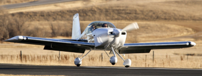

Looks like the EXP119...note cowl exhaust "bumps"
