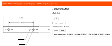

jcarne Well Known Member Patron Jul 29, 2024 #1 Can someone tell me the thickness of this part if you have one you can measure. I really don't want to wait to order one for my new rudder and would rather fabricate it. Thanks! Attachments Screenshot 2024-07-29 142758.png 189.8 KB · Views: 105

bjdecker Well Known Member Ambassador Jul 29, 2024 #2 Fab it out of a piece of .032" - .063" Put a couple of washers between it and the recesses in the lead counter weight.

jcarne Well Known Member Patron Jul 30, 2024 #3 Looks like they call for them rivet holes to be countersunk. Narrows it down to 2 choices. .063 it is. Thanks
