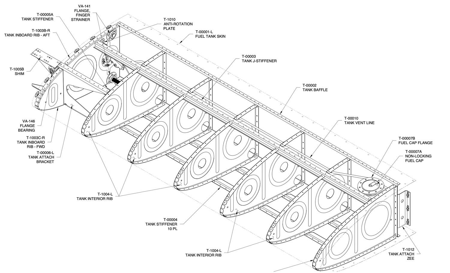

Pull the tank, cut an access hole in rear web, replace the affected rivets and reseal. Not that difficult to do and it is the proper way to seal your rivet leaks.
Dave's re-formed rivet works fine, but if you have more than a few with blisters, chances are you also have some waiting to happen. May as well bite the bullet...
Access holes; four rear, one end web, and the sender hole..
Sharp fly cutter works fine.
Closed end rivets.

I've cut the hole with a fly cutter as well. Go slow, sub 10 RPM. After I made practice cuts with the fly cutter and hole saw, I made the real hole with the fly cutter.
One tip when cutting thin metal with a fly cutter or hole saw, after the center drill bit has made it through, switch to a smooth rod to guide the tool.
The drill bit flutes will tend to auger out the guide hole and allow the outer cutter whether fly cutter or hole saw to wander around, and sometimes grab.
Sometimes you can just extend the pilot drill out enough so the flutes are not still in the sheet metal, sometimes you need to remove the drill and insert a piece of round stock.
Either way, safer and better quality of big hole production.

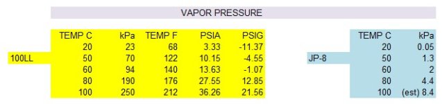

The primary factors are (1) excessive countersink depth or oversize dimples, combined with (2) vapor-impermeable paint coatings. There are a number of lesser factors, and the mechanics are interesting.
Roughly 20 years ago Philippine QB tanks were taking a well-deserved reputation hit, but the issue was also showing up with slow build tanks assembled using the same methods. Since then things have changed...which is why I asked when the OP's tanks were assembled.
