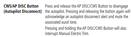

I have a semi-related question. What's the best way to kill the autopilot system in flight just in case something goes haywire?
1) I understand that a long hold of the AP Disconnect switch should shut everything down... right?
2) Or is it best to put the AP servos on circuit breakers?
3) What about disabling ESP? For a non-aerobatic airplane (RV-10) is it necessary to have a switch to disable that just in case? Or will options 1 and/or 2 suffice?

1. A momentary press of the Autopilot disconnect button will disengage the autopilot.
2. You will find the main Autopilot interconnect drawing on page 24-9 of the G3X Installation Manual (Rev AU). On this page, you will see that each servo is powered by #22AWG wiring, protected by 3A circuit protection.
3. ESP can be armed/disarmed in the AFCS menu. A configuration setting determines if ESP Is armed or disarmed on each power up. The switch is an optional alternate method to inhibit ESP. It will remain inhibited for as long as the switch is active. When ESP is armed, and one or more of the defined ESP thresholds are crossed, it is possible to remove the servo torque being applied to the control surfaces by ESP, by pressing the AP Disconnect button, activating the remote switch if installed, or disarming ESP in the AFCS menu. When using the AP disconnect button, if the switch is released, servo torque will resume if the aircraft is still outside of the defined threshold. If the AP disconnect is pressed and held for more than 5 seconds, subsequent ESP driven servo torque will be inhibited, and the pilot will be notified by a CAS message. More information on Autopilot operation can be found in the G3X Touch Pilot's Guide, beginning on page 315. ESP information can be found beginning on page 307.

How does this interact with CWS if you have it enabled? With CWS enabled, a long press of the AP Disconnect button I assume just means you stay in CWS mode for a while. Does enabling CWS prevent the "hold for 5sec disables servo torque"?
I checked the G3X Touch Pilot's Guide and I see everything you were talking about but nothing about the "more than 5 seconds hold".
Holding for more than 5 sec disabling the servo is only when ESP has engaged due to an envelope excedance.
Under normal circumstances within the envelope (ESP not engaged) you can hold the disconnect button as long as you want to enable CWS. NOTE: This also disables trim.
CWS is an autopilot function and only applies when the autopilot is engaged. ESP functions only when the autopilot is not engaged, so there is no interaction between these.
Page 308 in revision Y.
