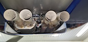

Following the recommendation I got from Clint at Vetterman, I’m running four straight pipes in my RV-8. I’m very happy with how it turned out, and how well the engine cools with the setup. The attached photo implies too many pipes in the cowl exhaust area. Not true. I never have a high CHT or oil temp problem. I’m running a stock cowl and a 8.5 compression IO-360-M1B.
Carl
Carl
Same. 9:1. Quiet was not a driver in my selection.
