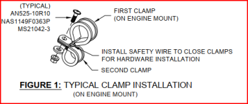

Anyone have part numbers for the proper sized clamps for the engine mount to secure everything?
10 4, tubes are 3/4 and slightly bigger. ThanksI don't have an RV8 but the engine mount tubes likely aren't all the same size. Rather than asking on here for a one size fits all answer, it's probably better to just measure and order as appropriate.
The last 2 digits in the part number is the diameter in 1/16".

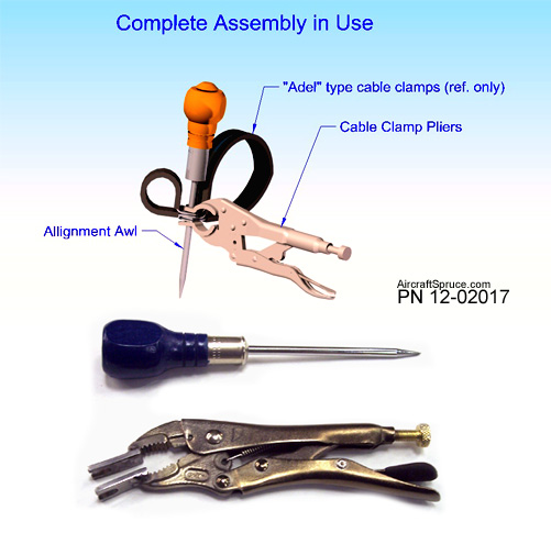

Geez Larry- those things are anywhere between 2 and 15 bucks a pop for the common sizes. I stand by my opinion that they're overkill for most of what we're doing, but you're going to have one of the nicest airplanes in the country when done. I think I've said it before, but I'm going to be embarrassed to park next to you when you get that thing flying.You need the heat resistant Adele firewall forward. I prefer MS21919WCJ
They are fuel and heat resistant.
I got them at an Airventure long ago. Can't afford them now!Geez Larry- those things are anywhere between 2 and 15 bucks a pop for the common sizes. I stand by my opinion that they're overkill for most of what we're doing, but you're going to have one of the nicest airplanes in the country when done. I think I've said it before, but I'm going to be embarrassed to park next to you when you get that thing flying.
I did use them to hold my red cube onto the runners, (size -23!) But only because I found a bin of them surplus from when Beechcraft killed off the Hawker line and picked them up on the cheap. If I'd sourced them retail they were going to cost me close to $50 a pop for that size.
