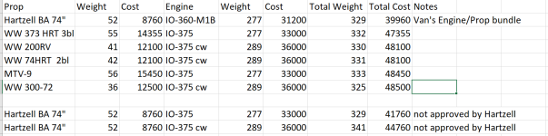

Research
I compiled the data from this thread and some research. The prop weight and prices are accurate as of today. The engine weights are approximate and 12lbs apart for a counterweight/dampened crank based on the post above. The engine prices (except for Van's) is a wild inaccurate guess. I'm happy to update if numbers are provided.
I take no liability for incorrect information. Verify everything for yourself, it's merely meant as a discussion point.
Looks like the the extra 15 cubic inches and ~20hp is worth about 7-9 grand with insignificant weight difference. The biggest variance was 8lbs. They all seem like good options to me, and it's really up to personal preference.

For all those interested. With the -375, the counterweighted crank is 6 lbs heavier and costs a bit over $2300. This is of course on a new build engine, and not a retrofit to an existing engine.
One more datapoint to add, as of March 2021:
As of very recently, Whirl Wind Aviation has now designated ALL of their props except for the 300 series into a LEGACY product line, meaning they are supported but no longer available.
Those of us with Aerosport IO-375 "non-counterweighted crank" engines awaiting the purchase of a prop can currently no longer buy anything from them... until the 330 officially comes out.
Grrrrr.
Not long ago I was talking to Whirlwind about that exact engine. The 330 series with 3 blades can handle the non-counterweighted IO-370/375 cranks. Having said that it's a beefy prop and ~53lbs.
Since I haven't bought an engine, and still at the "thinking stage", I'm leaning towards the 330 series 2 blade, but then I'm limited to an (I)O-360 or a counterweighted crank on the (I)O-370/375. The 2 blade is ~40lbs
With a -370/375, the options are basically add 6lbs for a counterweighted crank, or add 13 lbs for the additional prop blade. The price difference between the two combinations was insignificant, $100 or so. More expensive crank, or a more expensive prop, so it basically balanced out on purchase price.
As always, verify all info with the manufacturers before deciding.
