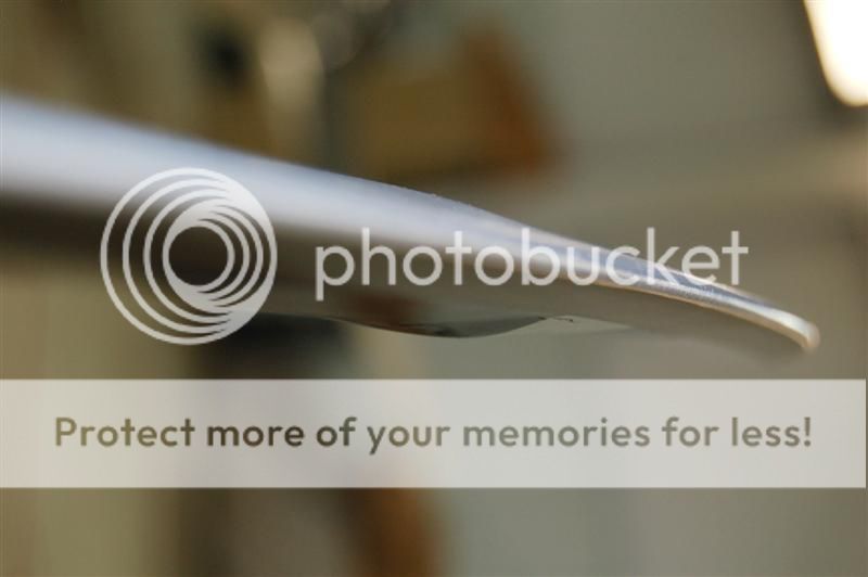

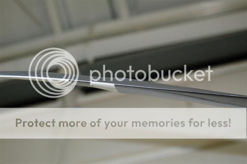

Had my excitement for the week. Shot a couple of touch & goes at Greene County (I19) and was heading over to Richmond. About 3 west of I19 started a VERY severe vibtatiion-- only slightly less at lower power settings. First thought I'd lost part of a prop blade and then that I'd had a motor mount fail. Scared me! Nursed her back for a straight-in to 07 and when I got to the hangar I found a big bulge-- 6" long and max 3/16 to 1/2 inch deep-- on both side of one blade just inboard of the tip stripes. New blade, less than 40 hours time.
Will post photos later

After Seeing Photos
Sensenich says this is what they thing happened. There's a "plug" at the hub end of our hollow blades. They think it came loose and was thrown outboard inside the hollow blade causing it to "bulge". So one blade was not only about a half-inch thicker just inboard of the tip, but it was also statically and dynamically unbalanced. They are sending new blades! I'll pull the cowl and check engine mounts, etc, VERY carefully.

Not a problem with the hub
The problem was the plug at the inboard end of the blade apparently wasn't correctly glue in place and that plug wound up 10" from the outboard end of the blade.

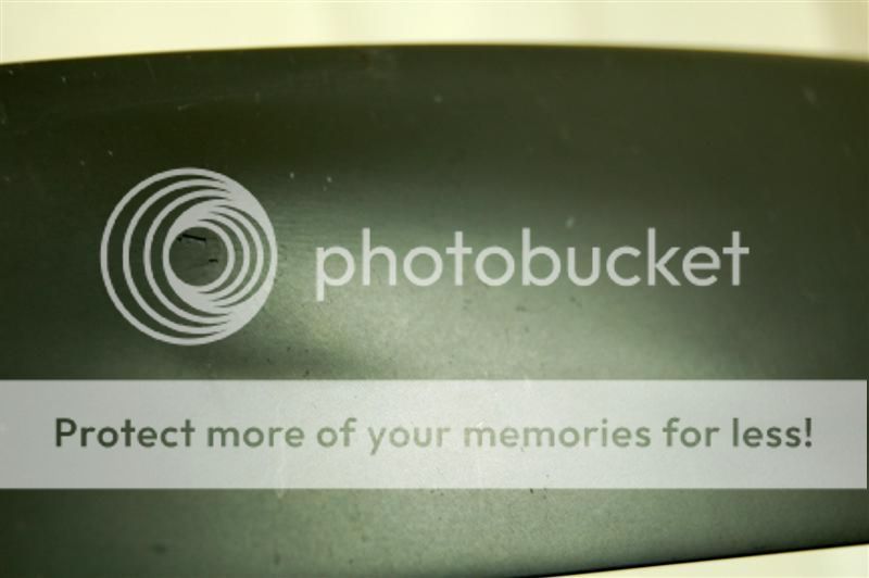

I just discovered this. It is on a stock E-LSA RV-12. It looks like an outer gelcoat has delaminated over top of the carbon fiber. I don't think I want to fly as is, so I imagine it will be going back to Sensenich for evaluation and or repair.
Anyone out there seen anything like this ?.
These props are nice, light, adjustable, efficient, but it only has 155hrs on it, I am a little disappointed. There is no indication on the leading that I picked up a rock or any FOD. Never saw anything like this on an aluminum propeller.
Harvey, your prop is definitely not airworthy. Looks like a manufacturing defect to me. I'm sure that Sensenich will be quick to determine the cause, and to get you back in the air. This also gives crudence to our preflight actions. Please post the results of you experience with Sensenich.....Tom
