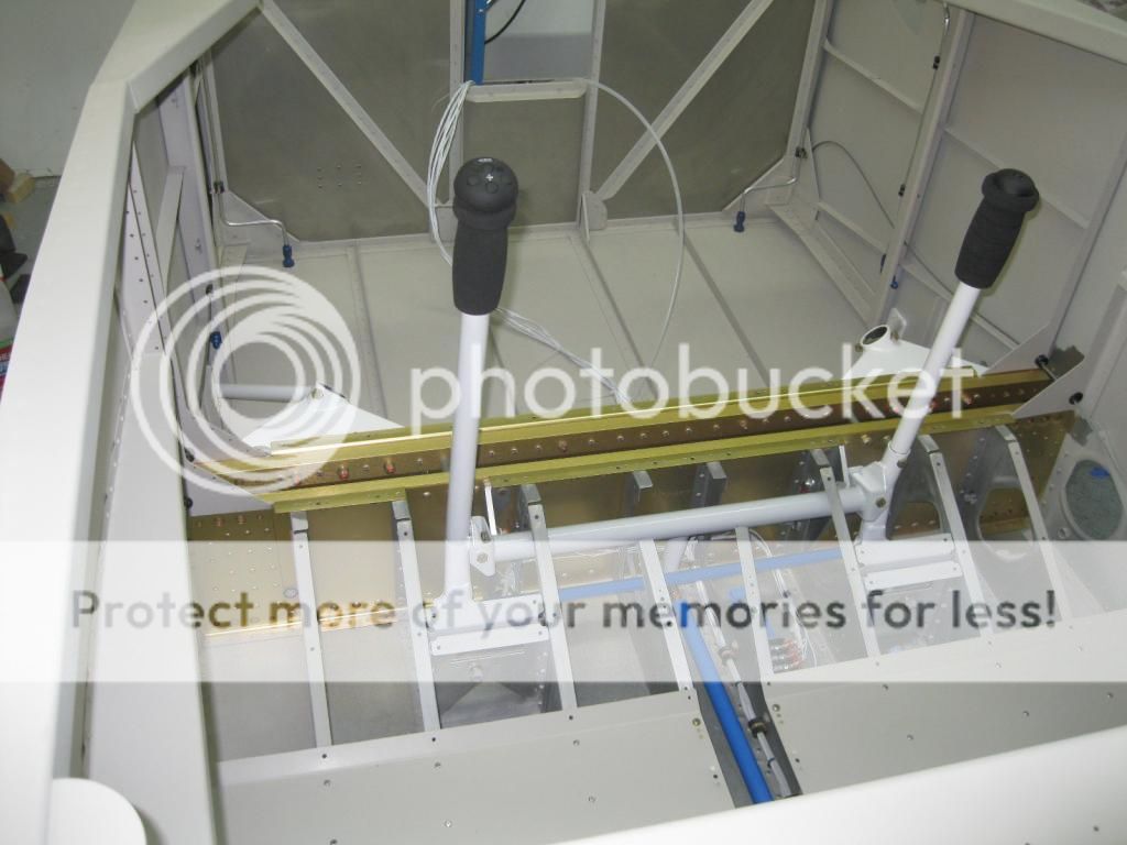

Primer on QB
I scuffed the inside of my fuselage with scotch brite and a wash cleaner, rinsed well with RO water. Primed with PPG two part epoxy. Light coat in the tail cone, heavier coat in the passenger and baggage areas for good appearance. Much more durable than the Sherman Williams was primer for the heavy wear areas. Doubt that it adds much protection from corrosion, but it looks good!
I had quite a few patches of corrosion come through on the bottom skins inside my 2009 QB fuselage, but it might have been a preparation/primer issue at the factory for those particular skins as the rest of the fuse wasn't affected.
I scuffed and primed over the SW wash with a 2k primer for peace of mind. The whole fuse interior only took a day to do. Well worth the effort I think?
